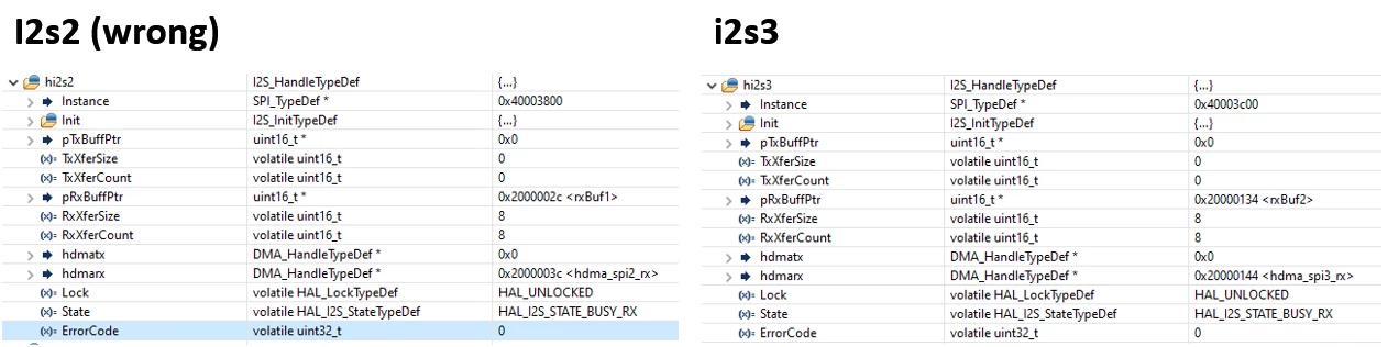

I have now setup the I2S3 in the same manner like the I2S2 and the I2S3 is working perfectly in stereo, but the I2S3 behave in the exact same way with no data (0 value) saved to the variable that DMA should fill. I am starting to suspect that the DMA is not setup or working correctly. I have setup both I2S's exactly the same in STM32cubeide/cubemx with circular mode and data width of half word. I am showing the code for reading the buffers below. Any clue of what is wrong?

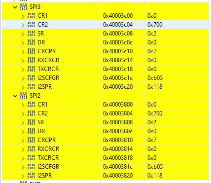

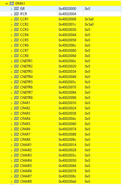

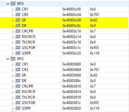

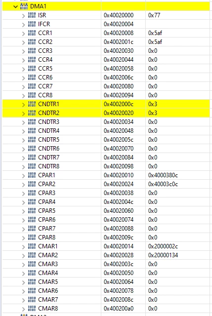

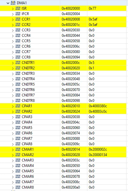

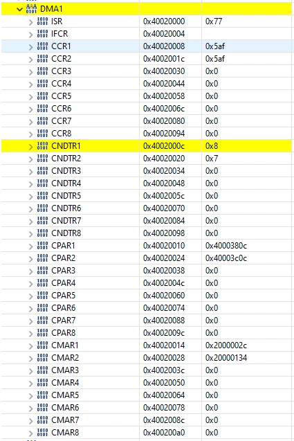

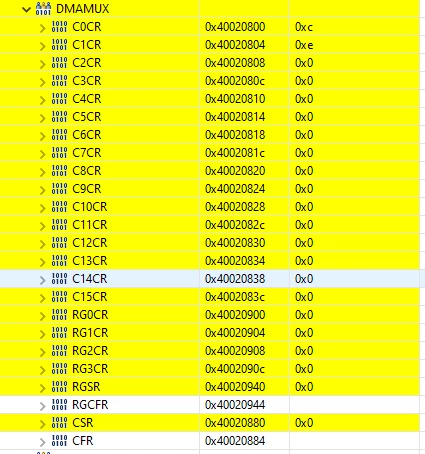

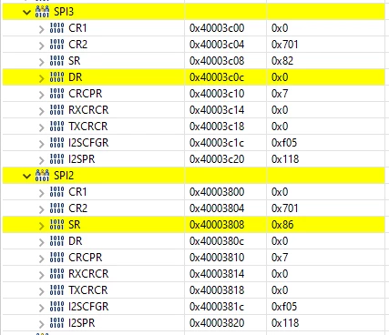

I don't get much out of observing these registers except for that the SPI2 DR register is never changing from 0, the SPI used by the I2S with a problem.
I start the I2S reception with
 HAL_I2S_Receive_DMA(&hi2s2, rxBuf1, 4);
 HAL_I2S_Receive_DMA(&hi2s3, rxBuf2, 4);
Have a go at what you think is the problem - here are some screenshots:
After MX_I2S*_inits:
SPIs
0693W000005BmZ1QAK.pngDMAMUX
0693W000005BmaiQAC.pngDMA1
After first RxHalfCpltCallback:
SPIs
0693W000005BmeVQAS.pngDMA1 (DMAMUX is unchanged)
0693W000005BmfYQAS.pnghist data structures
0693W000005BmXZQA0.pngLater RxHalfCpltCallback:
0693W000005BmheQAC.png0693W000005BmiNQAS.pngIn RxCpltCallback:

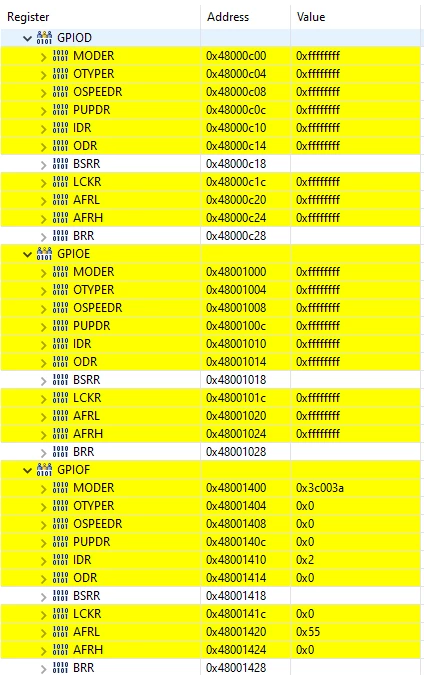

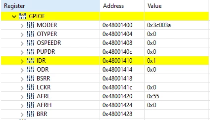

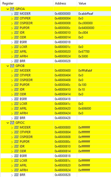

You haven't shown us the respective GPIO registers' content. DR being stuck at 0 - while everything otherwise indicates I2S and DMA running OK - sounds much like data pin for the given I2S not being set in GPIO.
As for interrupts appear to be missing, try a much slower I2S clock, that could perhaps reveal if it's the bloated Cube code or something else.

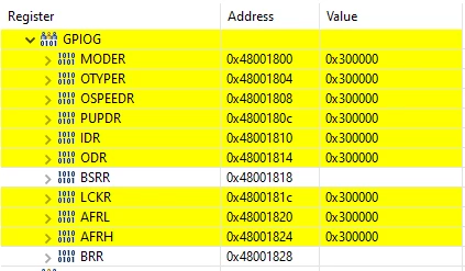

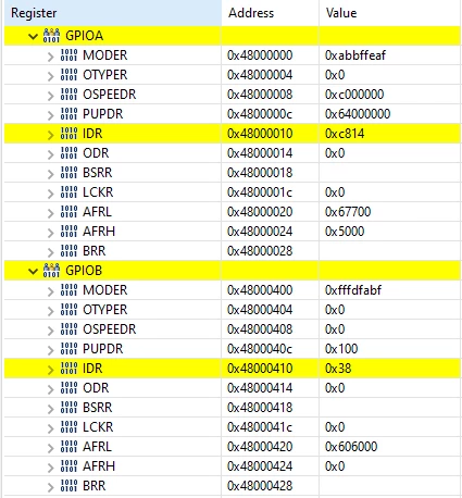

Here are the GPIO registers just after the I2S init:
In the first RxCpltCallback only these registers changes:0693W000005BuoOQAS.png0693W000005BuoxQAC.png
In successive callbacks only the IDR registers of GPIOA, GPIOB and GPIOF changes. Crossing fingers that there is a simple fix.

Appears OK.
So, you have set I2S CK and WS to PF0/PF1? Do you see those two clicks on those pins, observed by oscilloscope or LA?
Isn't HSE enabled in RCC?
