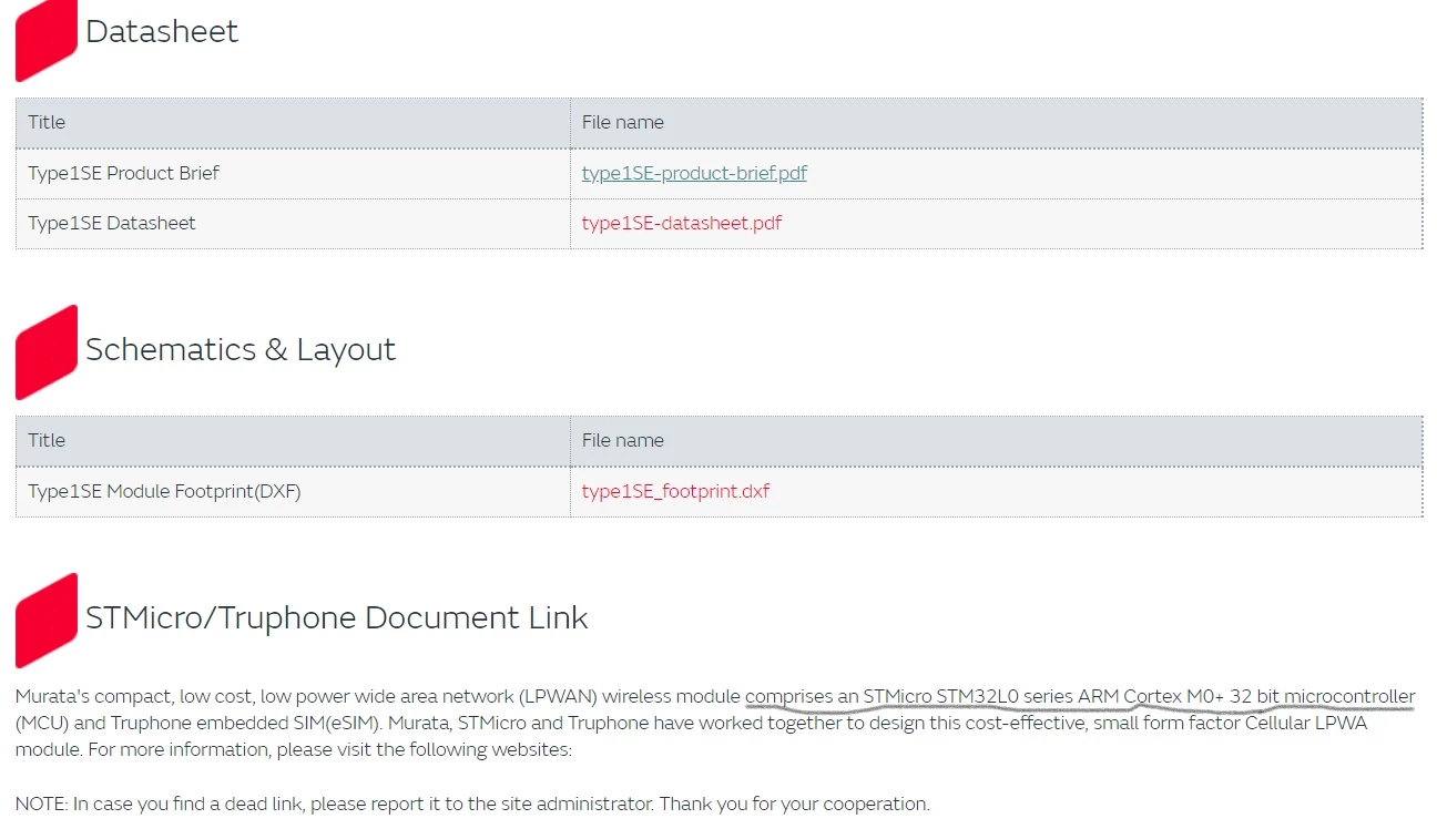

Does the Murata Modem TYPE1SE have an STM32L462RE inside?
I believe it has an STM32L462RE inside as it says in the datasheet, however I was a little confused when I read the underlined sentence in the picture bellow. In the datasheet it says there is a M4 inside, however this sentence refers a M0. I just want to get some clarity.
Thank you in advance.

Sometimes it could be helpful to include an URL instead of screenshots so that you know where the information is coming from.
Anyway, on the European website of Murata for Type 1SE it says that the STM32L462 is used, a Cortex-M0 is not mentioned there (anymore?).
Good luck!
