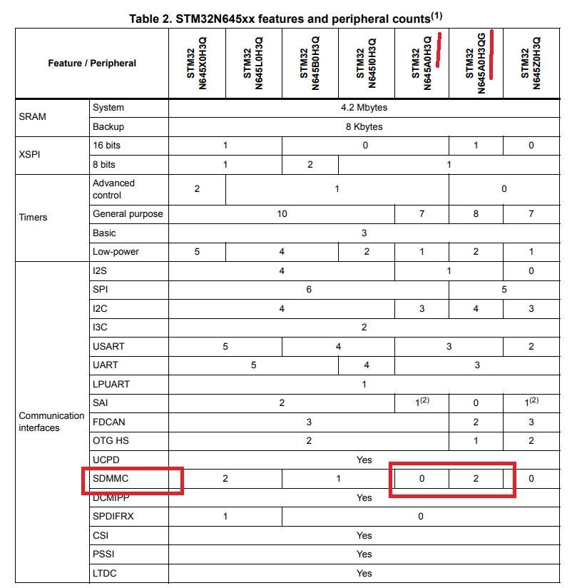

Does the 66 mm package of the STM32N6 series expose the pins required to use the SDMMC controller?
I understand that SDMMC support may depend not only on the MCU series, but also on the specific package and pin availability. I have seen SDMMC listed in the device features, but I am not sure whether it is actually usable on the 66 mm package.
Specifically, I would like to know:
  1. Is SDMMC available on the STM32N6 66 mm package?
  2. If yes, does it support a practical SD/eMMC interface, such as 4-bit mode?
  3. Are there any package or pin-mux limitations I should be aware of?
Any confirmation from someone who has checked the datasheet/pinout or used this package would be appreciated.

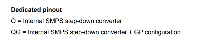

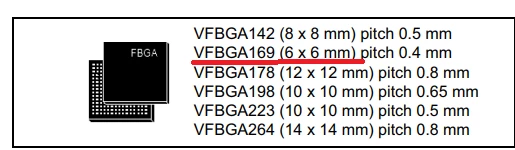

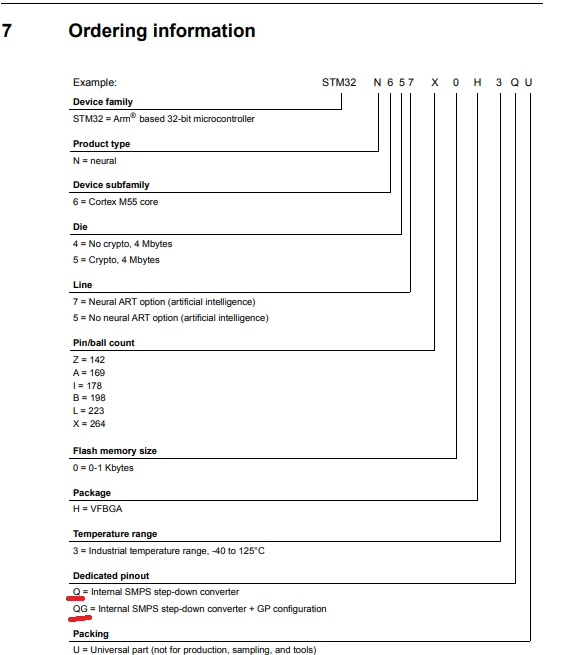

The answer to that kind of question could be found in the datasheet:
6×6 mm package means: VFBGA169 package:
So that depends on the pinout configuration:
xxxH3Q: no SDMMC interface
xxxH3QG: has two SDMMC interfaces
Please refer to the reference manual for SDMMC details and the Errata Sheet for the limitations of the product.
