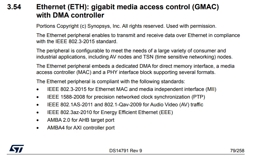

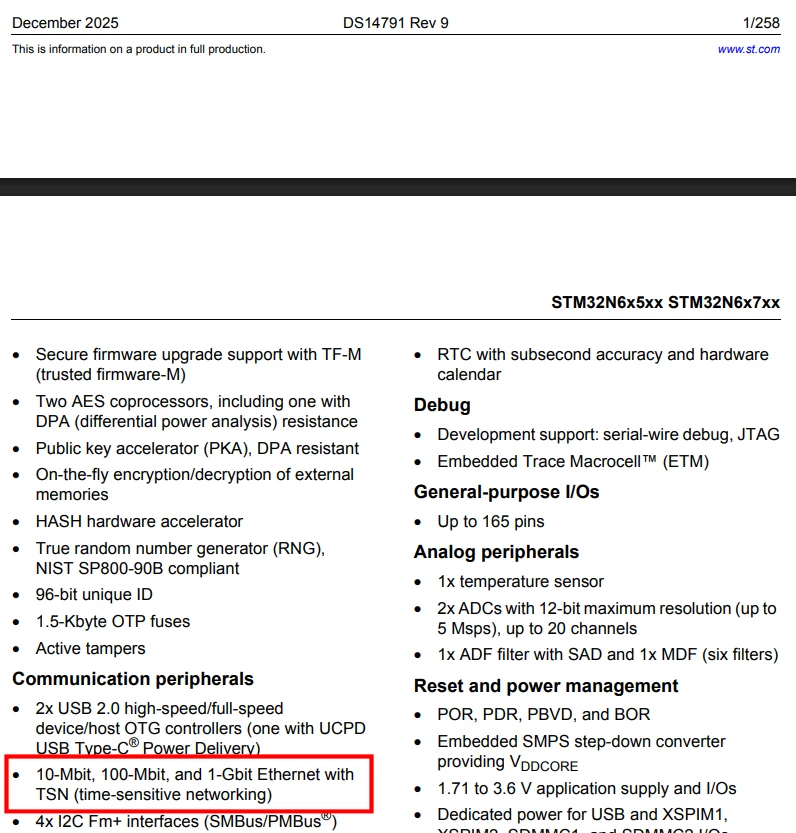

I would like to confirm whether the Ethernet MAC available in the STM32N655x0H3Q supports 1000 Mbps (Gigabit Ethernet) operation.

The Datasheet would be the place to check:
https://www.st.com/resource/en/datasheet/stm32n655x0.pdf
via: https://www.st.com/en/microcontrollers-microprocessors/stm32n655x0.html

1G is supporting in this controller. I have tested it with netxduo web server.
