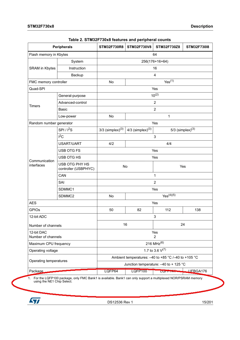

Does STM32F730V8 support SDRAM or not?
It says specifically in datasheet that it does, but when I create new STM32CubeIDE project and select STM32F730V8, FMC only offers PSRAM/NOR Flash/LCD interface. I tried for testing purposes selecting some other MCU that also supposedly supports SDRAM, I did get a choice of selecting it. Am I doing something wrong?

waclawek.jan
Apr 28, 2020 8:05 PM UTC
Does the selected package have all pins needed for SDRAM?

waclawek.jan
waclawek.janBest answer
Apr 28, 2020 8:08 PM UTC
Slina
SlinaAuthor
Apr 28, 2020 8:11 PM UTC
Damn, I missed that part. Thanks.
