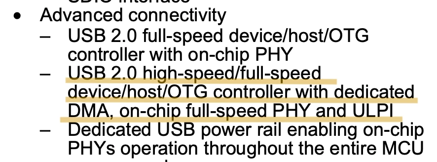

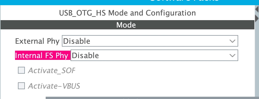

I have spent a few days trying to select the correct MCU for a project and trying to minimise the need for external ICs For example, I need the STM32F479VI MCU to appear as a USB Full Speed (480 Mbps) device.
However, in CubeIDE, when I select USB-OTG-HS I get the following screen,
The manual says,
It mentions USB 2.0 high-speed + host controller + on-chip full-speed PHY
I think this will only work with an external USB 2.0 High-Speed PHY.
Are there any STM32F4 that have an internal USB 2.0 High-Speed PHY?

No, most STM32 need external phy for USB HS. There are only a few exemptions, like F723 and U59.

Thanks,
With so many options it was hard to find this clearly started. Your answer is appreciated! External PHY it is then.
