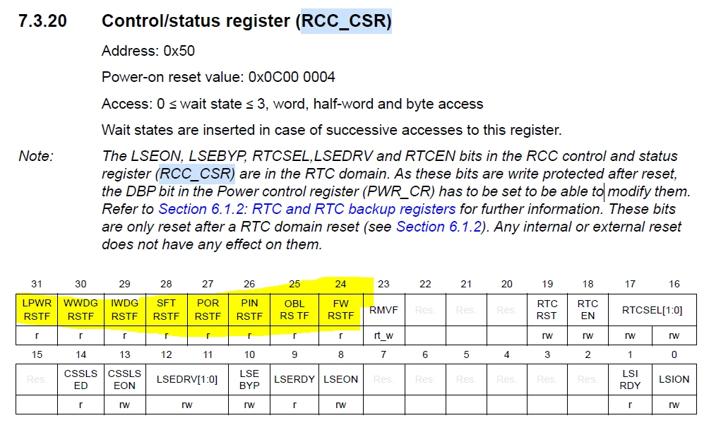

> Does STM32 have registers to determine the restart type?
Yes it does. The RCC->CSR register contains flags that show the reset source.

Thanks for the reply, but the RCC register cannot determine whether it is reset by wakeup pin or RTC interrupt reset. Is there any way to determine whether the way to exit low power consumption is wakeup pin interrupt or RTC?
January 11, 2021
There are also flags in PWR_CSR.
