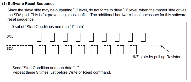

Does STM32 HAL support sending “commands�? over I2C to FRAM IC like MB85RC64TA?
  • April 17, 2023
  • 3 replies
  • 940 views
Such “commands�? specified by this FRAM IC vendor are supposed to set “Speed Modes�?, set a “Sleep Mode�?, etc.
This require sending multiple START conditions followed by some data.

The HAL I2C driver does support repeated start. (No idea what is multiple start)

_legacyfs_online_stmicro_images_0693W00000biGDRQA2.pngFrom the FRAM IC spec: "9 set of Start Conditions and one "1" data"

What the I2C peripheral can do is likely STM32 family related.
I don't know there's specific accommodation for out-of-ordinary use cases, but I'm pretty sure any signalling could be emulated with the application of effort.
