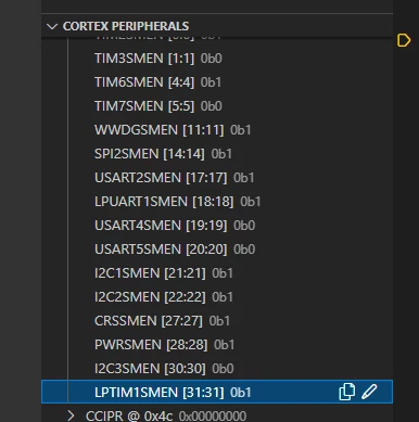

Thanks for your reply, the flag is set by default please see the attachment, even setting the flag in the init function of Lptimer does not change anything, here is my init and preenable function for LpTimer did I miss anything ??:
void initLptimer()
 LL_APB1_GRP1_EnableClock(LL_APB1_GRP1_PERIPH_LPTIM1);
 Clock::EnableLSI();
 LL_RCC_SetLPTIMClockSource(LL_RCC_LPTIM1_CLKSOURCE_LSI);
 //Enable LPTIM IN SLEEPMODE
 SET_BIT(RCC->APB1SMENR, (RCC_APB1SMENR_LPTIM1SMEN));
void preEnableLpTimer()
 LL_LPTIM_Enable(this);
 while (LL_LPTIM_IsEnabled(LPTIM1) == 0); // wait until timer is enabled
Best,
CoffeeMaker

Maybe I did not mention before that our FW works but it crashes sometimes and remains stuck exactly at this line :
  1. while(LL_LPTIM_IsActiveFlag_CMPOK(LPTIM1)==0)
Basically, the Lptimer is enabled properly otherwise the FW won't work, so I found this issue discussed here Which explain this strange behavior caused by Lptimer with stop mode.
Any other reason could be behind this crash at that point?
