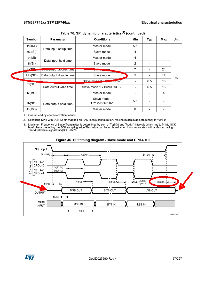

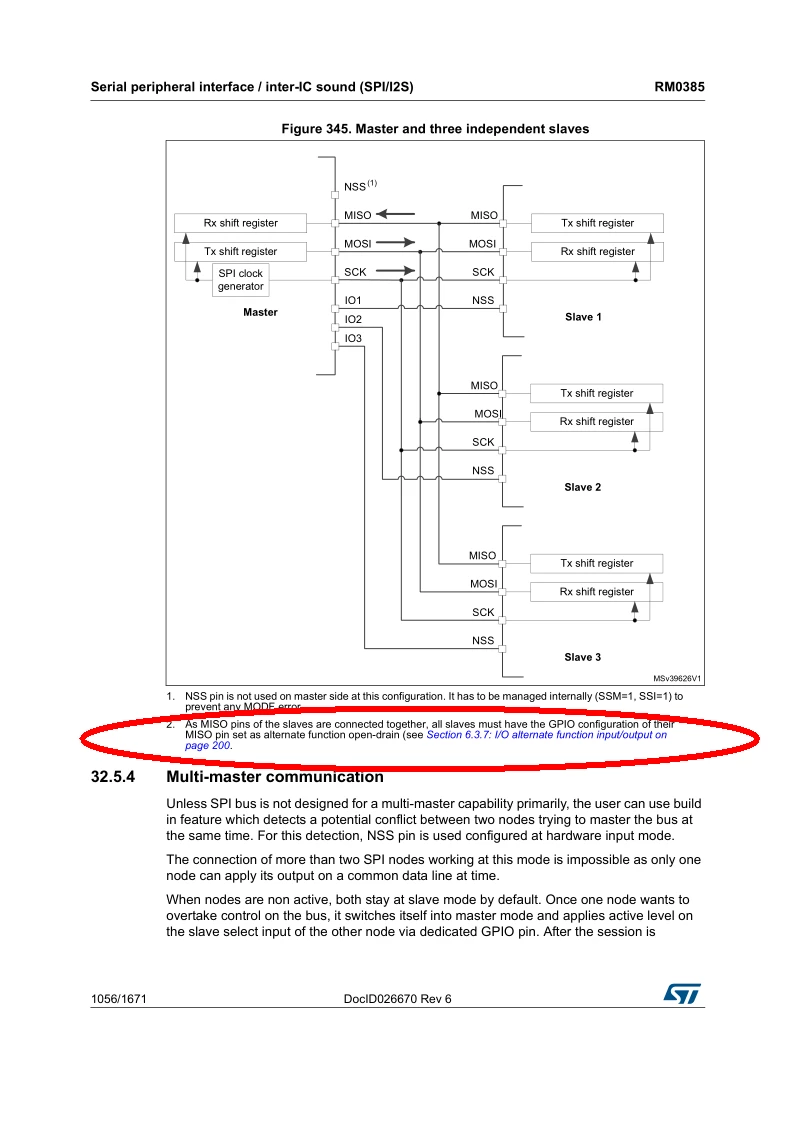

Does SPI in slave mode threestate MISO on inactive NSS, or not?
Posted on May 17, 2017 at 23:22
This is a followup to
https://community.st.com/thread/40921-multi-slave-spi-using-stm32f7s&sharpcomment-157367
RM0385, requests MISO being set to open-drain when multiple slaves are connected. This indicates, that NSS set to the inactive state *does not* threestate MISO in STM32 SPI set to slave, as is the custom with SPI. This makes using multiple STM32 SPI slaves not practical.
Other than this, I could not find any indication of MISO behaviour in this regard in the RM.

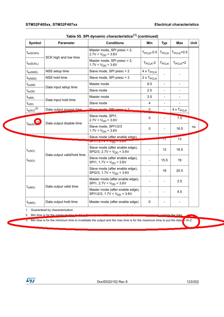

I also went to the respective datasheet and the graph indicates that MISO *does* threestate when NSS goes inactive:
The STM32F40x DS, in the same table, for the same parameter, the footnote clearly states that MISO is to be threestated (put to Hi-Z)
ST, please comment.

    MISO signal output is under standard chip select control of NSS input when the SPI slave is enabled and configured at HW NSS mode with NSS output disabled (SPE=1, SSM=0 nad SSOE=0). This allows multi-slave star topology communication.
    Best regards,
    Petr
