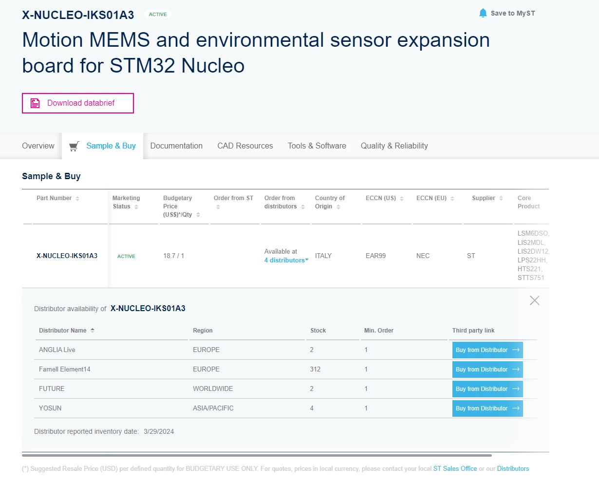

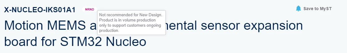

I was trying to buy IKS01A3, but it was out of stock, so I just bought IKS01A1. Because it seems same IC. Is it okay?
