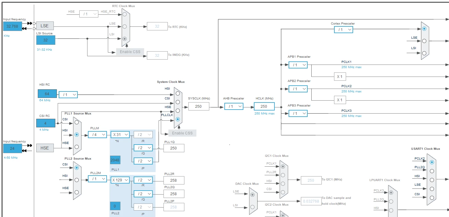

if you can share your system clocks and a screenshot to help .

Mar 29, 2024 8:18 PM UTC
the tutorial that you sent, I3C frequency setting is 3000khz.
  • Set Frequency I3C controller to 3000 kHz, as shown below.

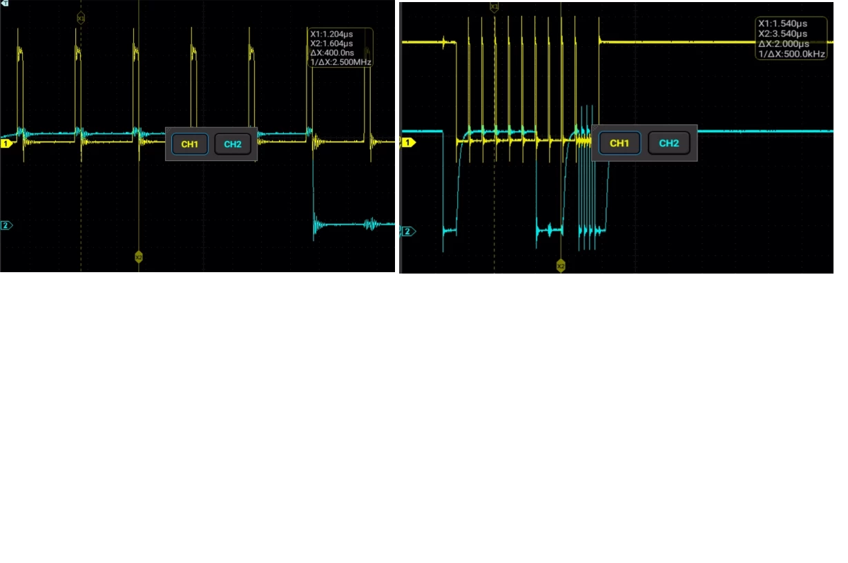

I tried 12500KHz, but it didn't work.  I wasn't even able to transmit the data.
12500khz_nack.pngThanks.

Apr 2, 2024 9:18 PM UTC
Foued_KH,
My target board is X-NUCLEO-IKS02A1. I was going to try with  IKS01A3, but it was out of stock.
Do you think there might be some problem?
but I can see the data communication by scope when I tried 3000Khz.
Thanks.
Luke.
Foued_KH
Apr 3, 2024 8:48 AM UTC
I don't think that X-NUCLEO-IKS02A1 supports sensors with I3C interface .
You can use X-NUCLEO-IKS01A3 ( LSM6DSO , LPS22HH ) or X-NUCLEO-IKS4A1 and for more details about I3C sensor communication, check this path :
STM32Cube_FW_H5_V1.2.0\Projects\NUCLEO-H533RE\Examples\I3C\I3C_Sensor_Private_Command_IT ( X-NUCLEO-IKS4A1)
STM32Cube_FW_H5_V1.2.0\Projects\NUCLEO-H503RB\Examples\I3C\I3C_Sensor_Private_Command_IT (X-NUCLEO-IKS01A3)
