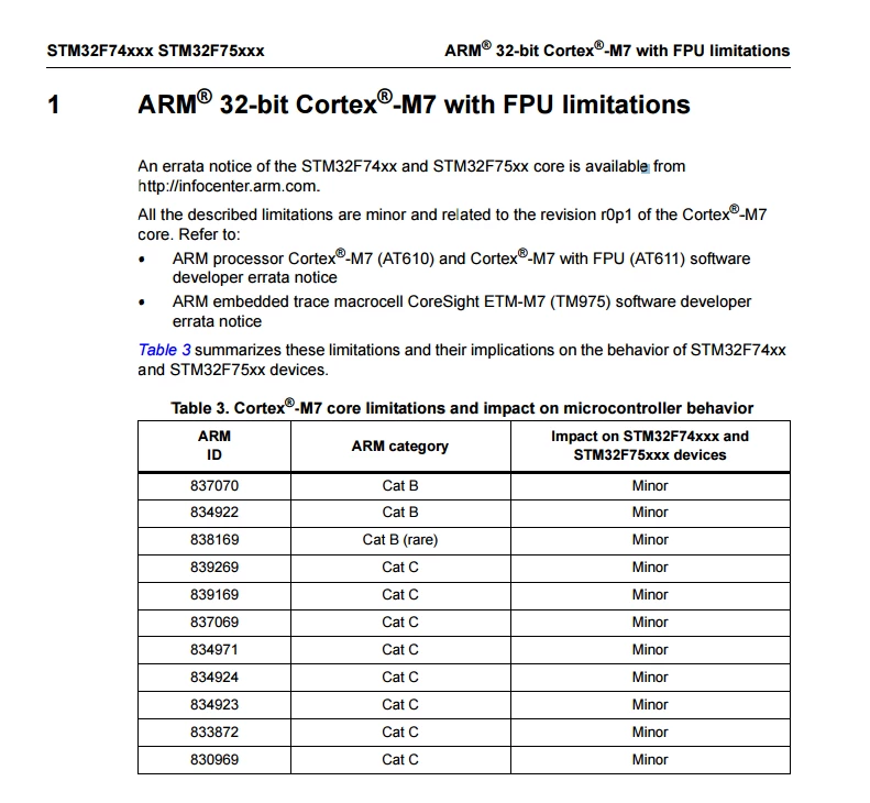

Hi. I have an STM32F746 Discovery board purchased late last year from Digi-Key. It uses a STM32F746NG chip. I have not found any documentation anywhere that defines which revision of the Cortex M-7 core it uses. I am programing using FreeRTOS and its portability layer has a port.c function for the CM-7 core revision r0p1. I see the latest (but still dated 2015) ARMCortex-M7 Processor Technical Reference Manual  is Revision r1p0 which presumably is later than revision r0p1.
How do I find out what revision the core is in any particular STM ARM chip?
Thanks.
    Imen.DBest answer
    Mar 13, 2017 10:29 AM UTC
    Posted on March 13, 2017 at 11:29
    As mentioned by Clive One, you may find more details in the
    http://www.st.com/content/ccc/resource/technical/document/errata_sheet/4d/39/a6/8c/84/47/47/67/DM00145382.pdf/files/DM00145382.pdf/jcr:content/translations/en.DM00145382.pdf

    I have a decoder for this and the FPU variant, but not near the system it is on
    http://infocenter.arm.com/help/index.jsp?topic=/com.arm.doc.ddi0489d/Cihhbddh.html
    SCB->CPUID  <- check this register
    DBGMCU->IDCODE
    https://community.st.com/0D50X00009XkaRrSAJ

    Clive, thanks for the info. on the SCB->CPUID register. It is documented, as I found out, in the PM0253 Cortex-M7 Programming  manual. By the time I read your second post here I had already written a routine to recover the rnpn number.
    And I discovered that it is r0p1 for the STM32F746NG chip as used in the STM746 Discovery kit. One of the links you gave above mentioned they thought that STM had only licensed the r0p1 core from ARM.
    Thanks to all who have posted.

    One of the threads went through a couple of edits, but the NUCLEO-F767 had the r1p0 part, the FPU-D and 2MB of FLASH
    The FPU-S devices probably just going to be the r0p1 core, unless ST steps the part, and that would reflect in the errata documentation.

    Check SCB->CPUID
    printf('r%dp%d\n', ((SCB->CPUID >> 20) & 0x0F), (SCB->CPUID & 0x0F));
