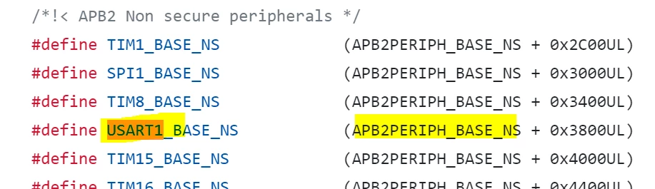

Is USART1 on APB1 (AN5593, tab.17) or APB2 (DS, RM, CubeMX) and USART2 on APB1 (DS, RM, CubeMX) or APB2 (AN5593, tab.17)? Guess, there is an issue in an5593-how-to-use-the-gpdma-for-stm32u5-series-microcontrollers-stmicroelectronics Rv.4 , isn‘t it?

As @TDK already said, the RM and DS are correct.
I reported the AN5593 documentation issue to be corrected (Internal ticket number 165109)

The RM/DS is correct.
When in doubt, you can go into the code and look at the memory address of USART1 and USART2 to see which one they're in.
