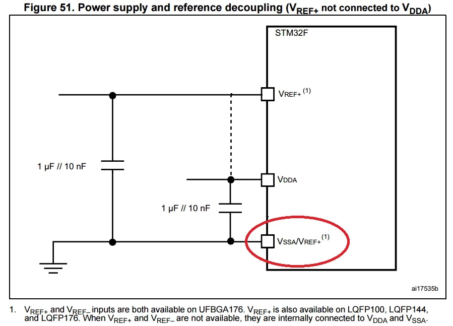

I don't understand the picture in STM32f4 datasheet p137. In figure 51 the Vref+ is shown as connected to VSS

    Definitely looks like it should be VREF-
