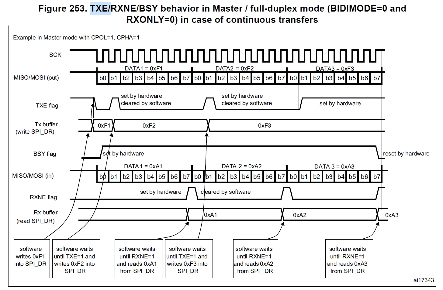

June 29, 2023
What you wrote will probably work okay if the SPI clock rate is high, but just because TXE=1 the transmission may not be complete. You should wait for BSY=0 after the final transfer before you pull CS high.
