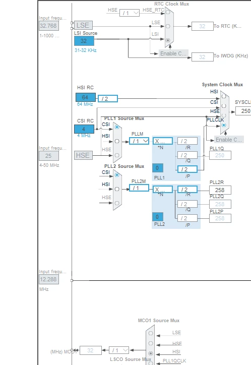

Do i need extrenal oscilator for STM32H503CBT6
if in the stm32cubeide clock configuration the extrenal oscialtors aren't highlighted it means that i dont need extrenal oscialtor on my custom board?

Hello @transistor and welcome to the ST community,
That depends on your application. For example, if you plan to use FDCAN interface you need a crystal.
Toggling a LED doesn't need a crystal. You can use HSI as a clock source.
Jul 8, 2025 10:39 AM UTC
i want to use i2c, pwm so the HSI should be enough?

Jul 8, 2025 10:40 AM UTC
If pwm is used for example to control motor speed, no need for crystal in that case. No need for crystal for i2c.
