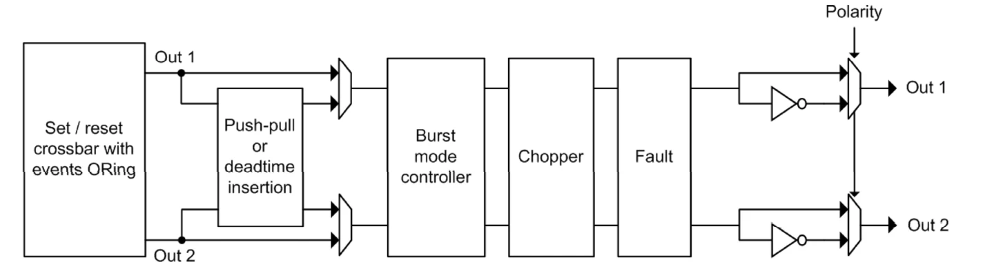

Assume that i set up an H-bridge and and control it via the HRTIM block and use the build in deadtime features. I then also enable a couple of faults. The bridges safe state will be to set both lower transistors to be OFF and the two upper once to be off.  I then run the H-bridge in a PSFB mode.
Now all of a suddenly a fault is triggered while the bridge is conducting. Lets say that "top left" and "bottom right" transistor is enabled.  Transition to safe state will cause the mcu turn off "top left" and turn on "bottom left" but will it respect the configured deadtime while preforming this transition or will it change both outputs simultaniously and risk a left side shoot thru on the H-bridge

According to the Reference Manual, "Once a fault has been triggered, the outputs take a predefined safe
state. This state is maintained until the output is re-enabled by software.". There is no deadtime when a fault occurs, all outputs are forced to the low level in case of FAULT event.

  • After a fault is triggered, outputs go into predefined safe states without any deadtime. It's an emergency procedure and we can see in the schema under that fault stage is directly close to the output to go faster. We even care about the impact of the filtering option on faults they can introduces a slight delay on the state outputs.

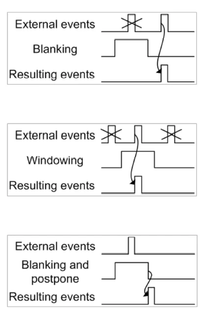

  • Did you consider the blanking or windowing mode ? In fact, we can have a quite similar behavior by conditioning faults signals.

I did not succeed in using hardware to fix this. Instead i made sure that any faults made sure that the entire H-bridge was drawn low and I then set the HRTIM FLT interrupt to be the highest priority in the system:
Inside the ISR I turned on the bottom transistors again. This gave me a "deadtime" to the deenergize state of around 550 ns which is not ideal, but a lot better than what i used to have.
Regards
