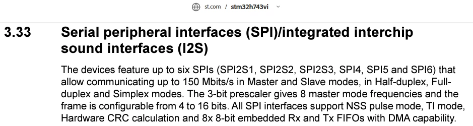

H7 series, like H743, has SPI with data size 4....32 bit frame.
SoCalJimAuthor
January 16, 2025
This says 4-16 bit frames. Are bigger frames available in software?

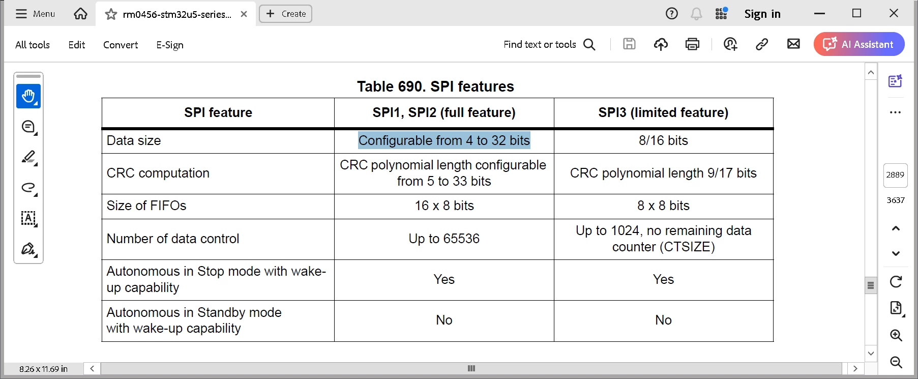

U5 has also 32 bit SPI.
Lead II
January 17, 2025
U5 has 4..32bit!
reference manual, page 2888, 68.2:
"From 4- up to 32-bit data size selection or fixed to 8-bit multiples"

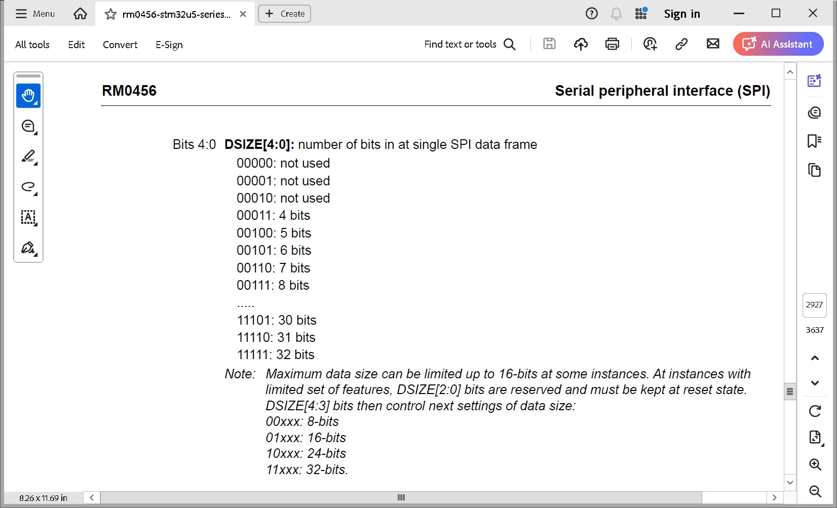

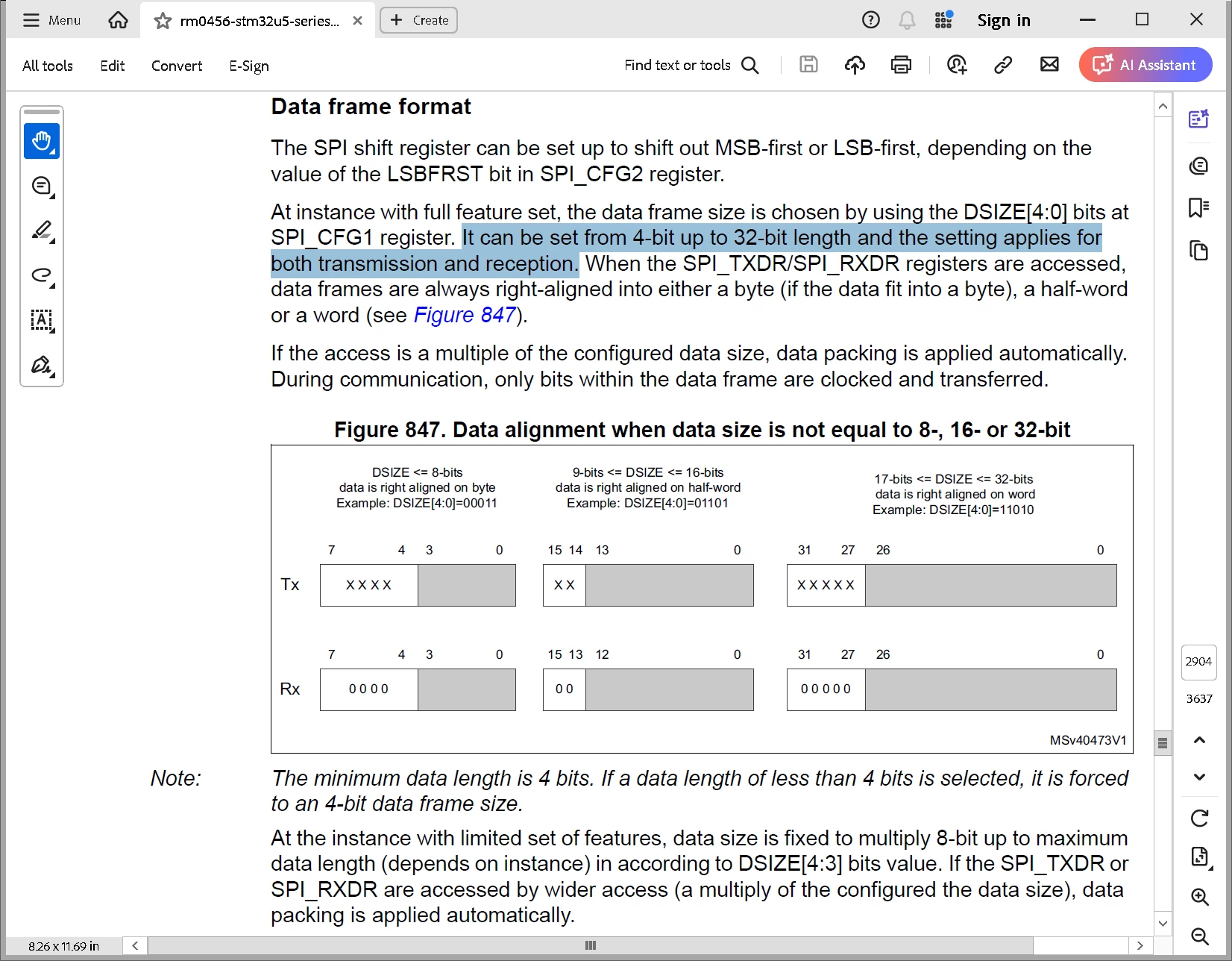

page 2904:
As I understand:
  • 20bit should be directly possible (or even as 5x 4bit, 2x 10bit)
  • Just: not all SPIs are "full feature"
