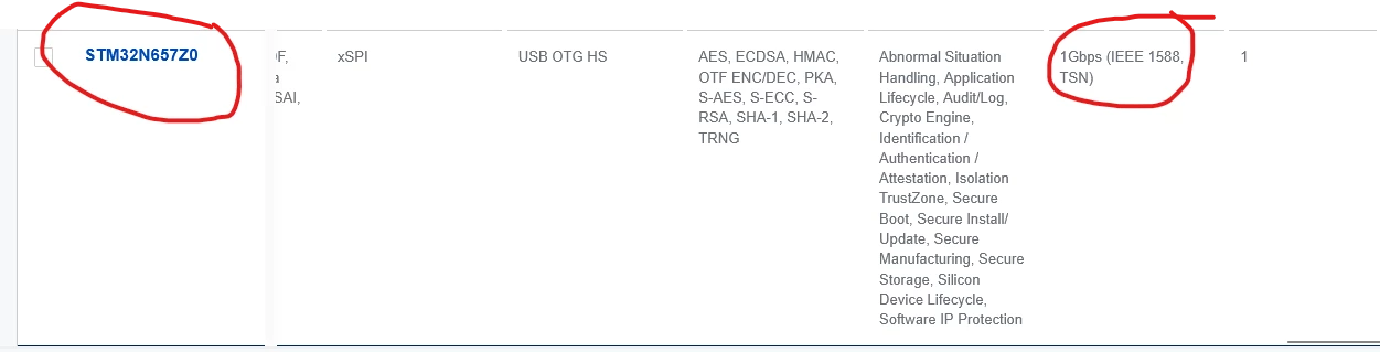

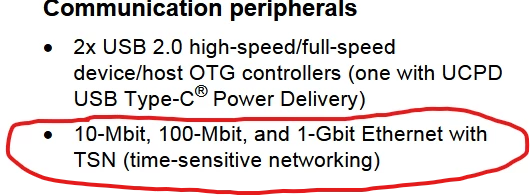

I’m working on a system design that incorporates gigabit Ethernet. I’ve been looking at using the STM32N6x7 family of parts to support this functionality. The product selector and datasheet seem to indicate that each package supports the 1000 Ethernet. In addition, the datasheet starts off by listing the gigabit Ethernet as a family supported technology. However, Tables 2 - 5 of the datasheet that list the variations in supported functionality between packages does not list Ethernet whatsoever on any package. To me this implies that the functionality is supported on all devices equally, otherwise the different protocols supported would be listed here.
Figure 1: Example of Product Selector Filter
Figure 2: Excerpt from Datasheet Listing 1 Gbit Ethernet Support for the STM32 Family

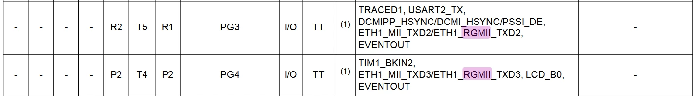

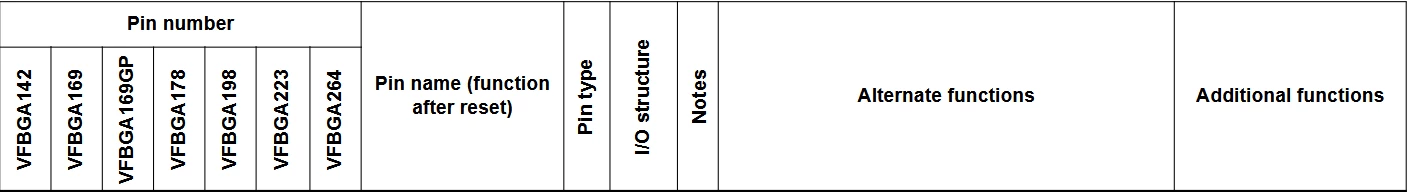

Thus, I started with the smallest package for ease of routing and space consumption. However, when matching the device with an external gigabit Ethernet PHY as required, I noticed that there are signals that are not present on the lower pin count models that are necessary for gigabit Ethernet.
Figure 3: Absence of RGMII TXD3, TXD2, and RXD3 Support for STM32N6x7 Packages with Fewer than 198 Pins
