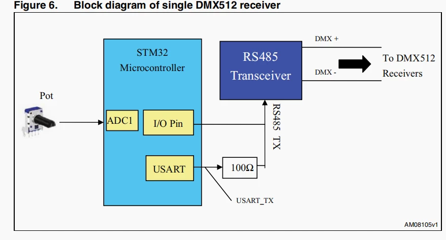

I have some problem with this code.
1-Break time is 44us but dmx need 92us at least how can solve this problem?

    June 27, 2024
    The USART module available on STM32
    microcontrollers has the ability to automatically generate a 12-bit long break signal,
    corresponding to 48 µsec at 250 k baud. Unfortunately, this is too short for use in a DMX512
    application as the protocol requires a minimum length of 92 µsec.
    Figure 6 shows the alternative hardware method chosen to generate the longer break
    signal. A 100 Ω resistor is connected in series with the microcontroller's USART transmit pin
    and the other end of the resistor to an I/O pin. With this solution, the break time can be
    varied, from 92 µsec to 176 µsec to meet the DMX protocol break time specification, when
    sending a break signal, the I/O pin is driven low. Later, the I/O pin is tri-stated to allow
    transmission from the USART to resume.
