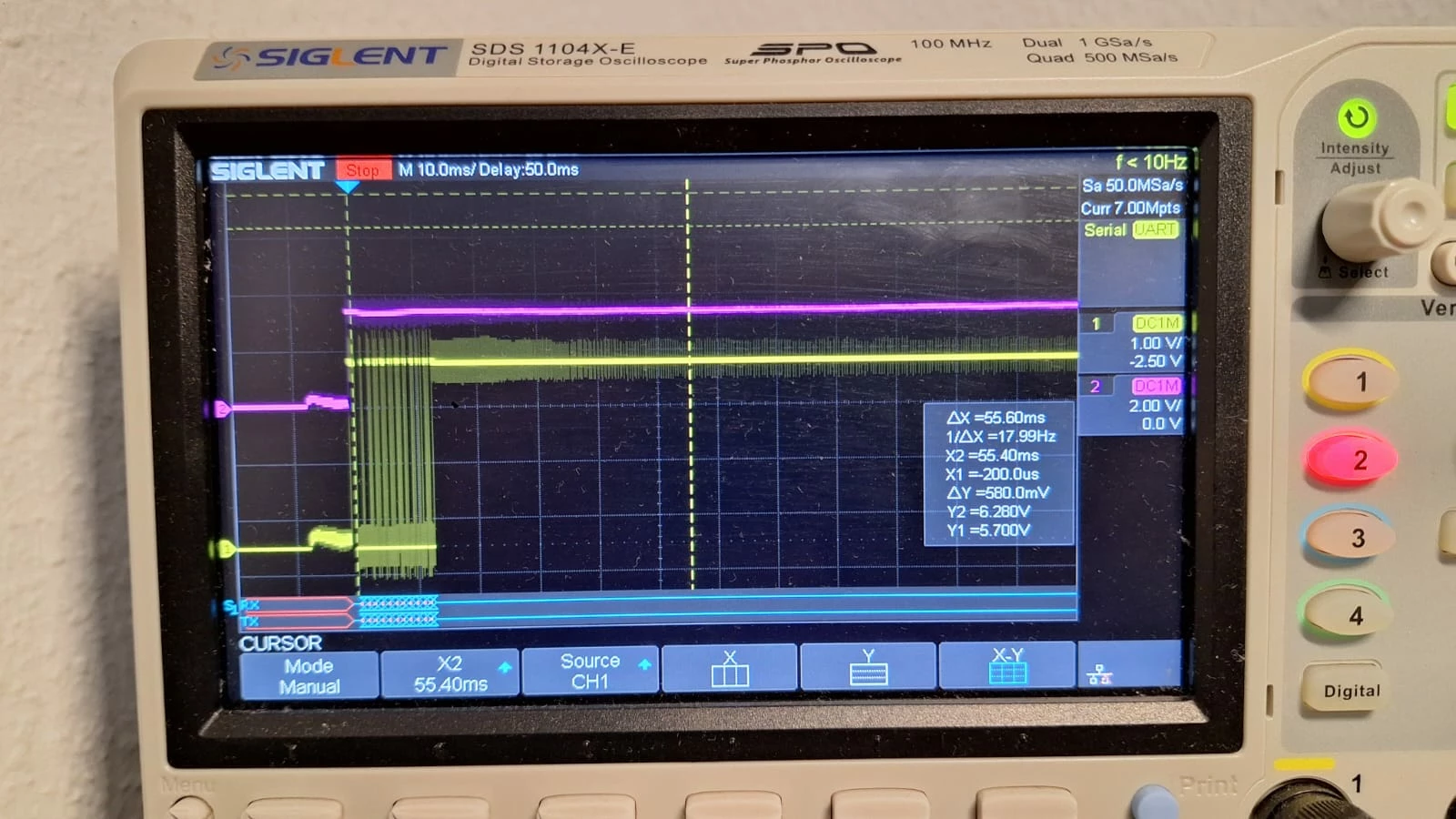

I am trying to implement Modbus protocol in an efficient way. Untill now I have implemented everhting with UART interuot based Transmission and recption. Now I would like to implement with DMA to offload controller from much neavy lifting. For your refernce, I somhow managed with the below code t transfer the TX_Array from 0x00 to 0x09. I verified this in oscilloscope. But this aimed frame is appearing only once then only 0x00 is seen infinitely. even DE pin is not driven to low. Which indicateds that ISR is not being called and transfer is not stopped. Or somewhere it make the controoller to hang. Please let me know where I am makeing mistakes.
Please pardon me, I will come back again for RX implementation after fixing this issue. Thank you.

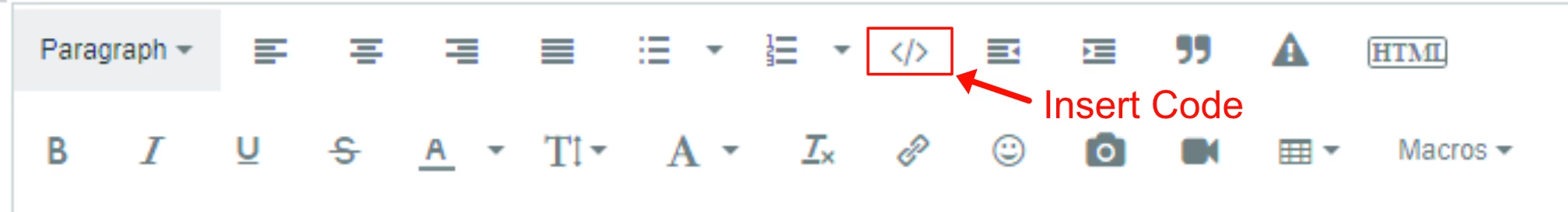

Use the </> when posting code so it's properly formatted

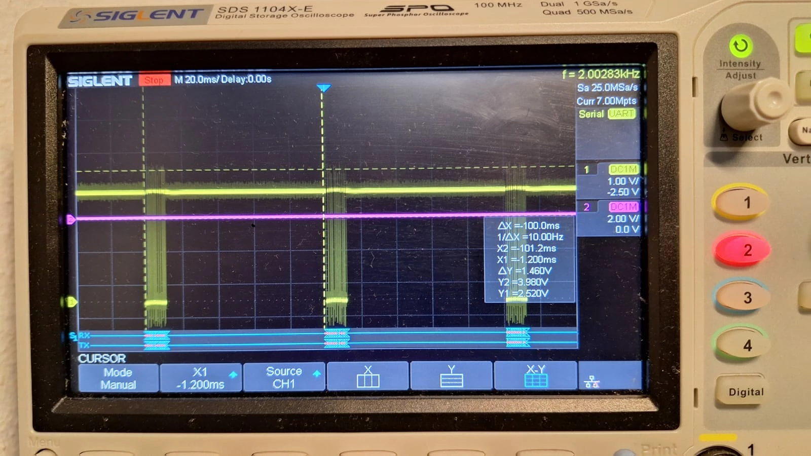

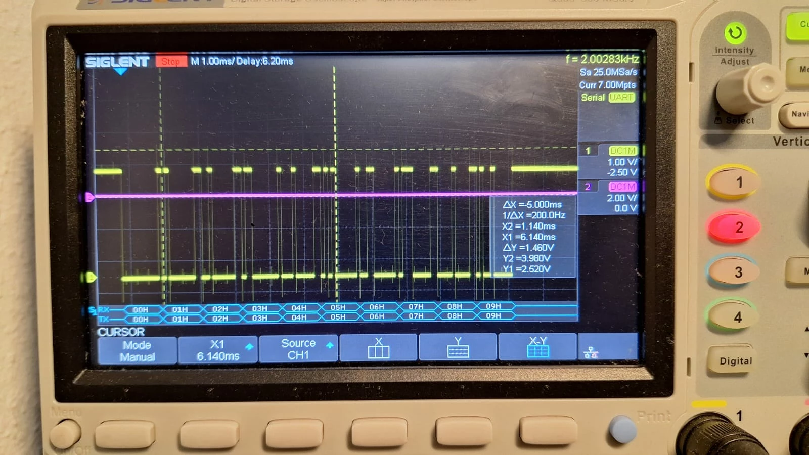

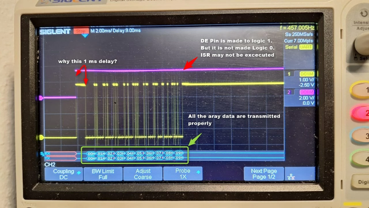

I have moved my function to transmit the frames outside of while(1) loop and I probed the TX pins and DE pin. I have attached photos of my oscilloscope plot too with my comments.
Please let me know my mistakes.
Here I have provided abstract of my code. Please let me know what I miss.

I modified the code and call initiate the transmission inside while (1) loop once in 25 nilli seconds.
As per my understanding and oscilloscope plots. It stops after 10 elements. when I just restart the micro controller. Later, no more tranmissions.
	while(1)
		//for (uint16_t temp = 0; temp < 1000; ++temp);
		MB_RTU_Transmit(TX_Array, 10);
		delay_ms(25);
Buit it is not restarting. Also I think it does not reach the ISR. Because I make teh DE pin to go Low there. Also I make an Reset LED to turn on for checking. But these commands are not excecuted.
void DMA1_Channel2_3_IRQHandler(void)
 if (DMA1->ISR & DMA_ISR_TCIF2) // Check if transfer is complete
 DMA1->IFCR |= DMA_IFCR_CTCIF2; // Clear Transfer Complete flag
 //DMA1_Channel2->CCR &= ~DMA_CCR_EN; // Disable DMA after transmission
 CLEAR_DE; // Optionally reset DE pin (back to receive mode)
 Switch_Reset_LED_ON;
I have the plot too.
