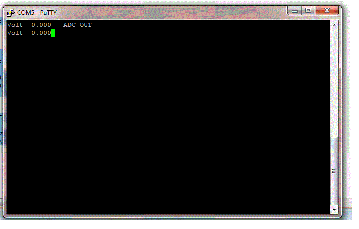

Dear All,
Some thing wrong with DMA operation please advice/* Includes ------------------------------------------------------------------*/

int main(void){
RCC_Configuration();
GPIO_Configuration();
ADC_Configuration();
USART_Configuration();
//DMA_Configuration();
sprintf(&Result[0],'' ADC OUT \r\n'');
Print(Result);
while(1){
read_adc();// doc ADC
volt=(float)(ADC1ConvertedDMAValue*3.3)/0x0fff;
sprintf(&Result[0],''\rVolt= %1.3f'' ,volt);
Print(Result);
delay();
Result is zero
