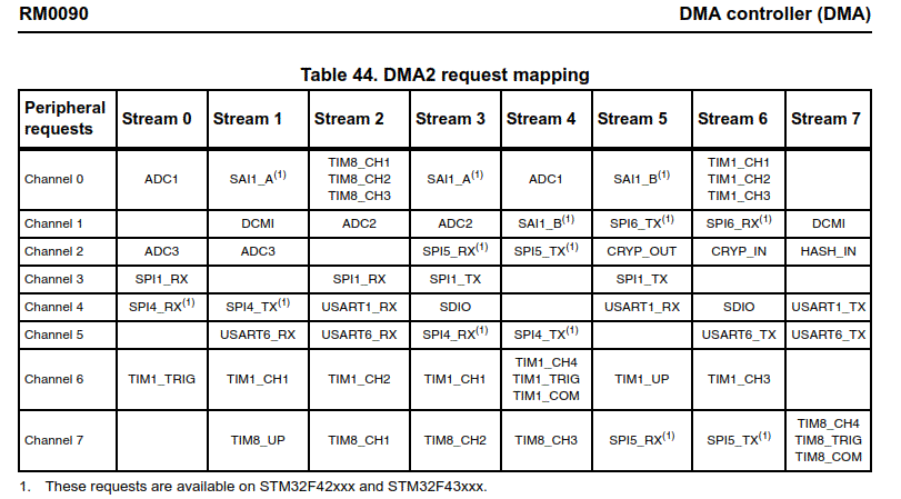

I am trying to get 24 ADC channels to transfer using DMA. The following code works for ADC2 and ADC3, but ADC1 the data stored in the DMA buffer is random. The data for ADC1 can sometimes appear correct, but the data is in the wrong position (e.g. ADCConvertedValue[0] data is located at ADCConvertedValue[3]). It is like the DMA is out of sync with the buffer positioning. ADC2 and ADC3 data appears valid and is not scrambled.
I have tried many different combinations of DMA and ADC settings, but can’t seem to get the whole thing working.
I don’t need an interrupt or an external trigger when the converstions are complete. I just need all 24 ADC channels continually transferring data to the DMA buffer in the background.
Any ideas on how to reliably get all 24 channels working? Why would the DMA transfer loose position synchronization with the data buffer?
Thanks in advance for any assistance.

    7 replies
    Tesla DeLorean
    Guru
    Aug 21, 2014 2:18 AM UTC
    Posted on August 21, 2014 at 04:18
    Isn't the point of triple mode to lock step the ADCs, use a single DMA stream, and read from the common data register, not the ADCx->DR? If you want it to work in Independent Mode, configure it that way.
    dlafreniere
    Aug 21, 2014 2:15 PM UTC
    Posted on August 21, 2014 at 16:15 Thanks for the quick response. I was not aware that the triple modes were only usable on one data stream. I did try various combinations of the ADC->CDR with the DMA without success. The table below seems to suggest that the a single stream cannot be used for all three ADC's. For instance, stream 0 channel 0 can be used for ADC1 and ADC3. Is that correct? I have tried changing:
    ADC_CommonInitStructure.ADC_Mode = ADC_TripleMode_RegSimult;
    To:
    ADC_CommonInitStructure.ADC_Mode = ADC_Mode_Independent;
    Which did notwork. I don't really care if the ADC's are in lock step, just that the ADC conversions are occurring in the background. 0690X0000060MmcQAE.gif

    // the destination memory location within the array: ADCConvertedValue[].
    // Running full speed without the debugger this ISR hack is not required.
    // Setting the stream number of data registers at the ADC end of
    // conversion fixes a problem with the DMA controller losing sync. Initially
    // the data loaded into the array is correctly positioned, then over time it
    // loses sync and starts copying the data to the wrong array index causing bad
    // ADC readings. Using a lower sample time with ADC_RegularChannelConfig()
    // exacerbates the problem, so ADC_SampleTime_480Cycles is the most stable when
    // using this debugger fix. However, this code will re-sync the DMA so the
    // out of sync readings are transitory and not permanent.
    DMA2_Stream0->NDTR = ADC1_SENSORS + ADC2_SENSORS + ADC3_SENSORS;
    DMA_Cmd(DMA2_Stream0, ENABLE);
    // ADC_Config
    static void ADC_Config()
    // Enable peripheral clocks
    RCC_APB2PeriphClockCmd(RCC_APB2Periph_ADC1 | RCC_APB2Periph_ADC2 | RCC_APB2Periph_ADC3, ENABLE);
    RCC_AHB1PeriphClockCmd(RCC_AHB1Periph_GPIOF | RCC_AHB1Periph_GPIOC | RCC_AHB1Periph_GPIOB | RCC_AHB1Periph_GPIOA, ENABLE);
    // ADC common initialization
    ADC_CommonInitTypeDef ADC_CommonInitStructure;
    ADC_CommonInitStructure.ADC_Prescaler = ADC_Prescaler_Div4;
    ADC_CommonInitStructure.ADC_DMAAccessMode = ADC_DMAAccessMode_1;
    ADC_CommonInitStructure.ADC_TwoSamplingDelay = ADC_TwoSamplingDelay_5Cycles;
    ADC_CommonInit(&ADC_CommonInitStructure);
    ADC_InitTypeDef ADC_InitStructure;
    ADC_StructInit(&ADC_InitStructure);
    ADC_InitStructure.ADC_Resolution = ADC_Resolution_12b;
    ADC_InitStructure.ADC_ScanConvMode = ENABLE;
    ADC_InitStructure.ADC_ContinuousConvMode = ENABLE;
    ADC_InitStructure.ADC_DataAlign = ADC_DataAlign_Right;
    // Initialize all ADC's
    ADC_InitStructure.ADC_NbrOfConversion = ADC1_SENSORS;
    ADC_Init(ADC1, &ADC_InitStructure);
    ADC_InitStructure.ADC_NbrOfConversion = ADC2_SENSORS;
    ADC_Init(ADC2, &ADC_InitStructure);
    ADC_InitStructure.ADC_NbrOfConversion = ADC3_SENSORS;
    ADC_Init(ADC3, &ADC_InitStructure);
    // Configure the GPIO pin for ADC input
    GPIO_InitTypeDef GPIO_InitStructure;
    GPIO_InitStructure.GPIO_OType = GPIO_OType_PP;
    GPIO_InitStructure.GPIO_Speed = GPIO_Speed_50MHz;
    GPIO_InitStructure.GPIO_Mode = GPIO_Mode_AN;
    GPIO_InitStructure.GPIO_PuPd = GPIO_PuPd_NOPULL;
    // Configure ADC1 GPIO's
    for (INT sensor=0; sensor<
    ADC1_SENSORS
    ; sensor++)
    GPIO_InitStructure.GPIO_Pin
    ADC1_CONFIG
    [sensor].GPIO_Pin;
    GPIO_Init(ADC1_CONFIG[sensor].GPIO_Port, &GPIO_InitStructure);
    ADC_RegularChannelConfig(ADC1_CONFIG[sensor].ADCx, ADC1_CONFIG[sensor].ADC_Channel, sensor+1, ADC_SampleTime_480Cycles);
    // Configure ADC2 GPIO's
    for (INT
    sensor
    0
    ; sensor<ADC2_SENSORS; sensor++)
    ADC2_CONFIG
    [sensor].GPIO_Pin;
    GPIO_Init(ADC2_CONFIG[sensor].GPIO_Port, &GPIO_InitStructure);
    ADC_RegularChannelConfig(ADC2_CONFIG[sensor].ADCx, ADC2_CONFIG[sensor].ADC_Channel, sensor+1, ADC_SampleTime_480Cycles);
    // Configure ADC3 GPIO's
    for (INT
    sensor
    0
    ; sensor<ADC3_SENSORS; sensor++)
    ADC3_CONFIG
    [sensor].GPIO_Pin;
    GPIO_Init(ADC3_CONFIG[sensor].GPIO_Port, &GPIO_InitStructure);
    ADC_RegularChannelConfig(ADC3_CONFIG[sensor].ADCx, ADC3_CONFIG[sensor].ADC_Channel, sensor+1, ADC_SampleTime_480Cycles);
    // Enable multi-mode DMA request after last transfer
    ADC_MultiModeDMARequestAfterLastTransferCmd(ENABLE);
    // Enable the ADC IRQ
    NVIC_InitTypeDef nvicStructure;
    nvicStructure.NVIC_IRQChannel
    ADC_IRQn
    nvicStructure.NVIC_IRQChannelPreemptionPriority
    0
    nvicStructure.NVIC_IRQChannelSubPriority
    0
    nvicStructure.NVIC_IRQChannelCmd
    ENABLE
    NVIC_Init(&nvicStructure);
    // Enable ADC end of conversion interrupt
    // (only required for DMA ''sync'' errors, see comment above)
    ADC_ITConfig(ADC1, ADC_IT_EOC, ENABLE);
    // Enable all ADC's
    ADC_Cmd(ADC1, ENABLE);
    ADC_Cmd(ADC2, ENABLE);
    ADC_Cmd(ADC3, ENABLE);
    // Start ADC1 (master) conversion. ADC2 and ADC3 will convert as slaves.
    ADC_SoftwareStartConv(ADC1);
    // DMA_Config
    static void DMA_Config(void)
    RCC_AHB1PeriphClockCmd(RCC_AHB1Periph_DMA2, ENABLE);
    DMA_InitTypeDef DMA_InitStructure;
    DMA_StructInit(&DMA_InitStructure);
    // ADC common data register, DMA2, Channel0, Stream0 configuration
    DMA_DeInit(DMA2_Stream0);
    DMA_InitStructure.DMA_Channel
    DMA_Channel_0
    DMA_InitStructure.DMA_Memory0BaseAddr = (uint32_t)&ADCConvertedValue[0];
    DMA_InitStructure.DMA_PeripheralBaseAddr = (uint32_t)&ADC->CDR;
    DMA_InitStructure.DMA_DIR = DMA_DIR_PeripheralToMemory;
    DMA_InitStructure.DMA_PeripheralInc = DMA_PeripheralInc_Disable;
    DMA_InitStructure.DMA_MemoryInc = DMA_MemoryInc_Enable;
    DMA_InitStructure.DMA_PeripheralDataSize = DMA_PeripheralDataSize_HalfWord;
    DMA_InitStructure.DMA_MemoryDataSize = DMA_MemoryDataSize_HalfWord;
    DMA_InitStructure.DMA_Mode = DMA_Mode_Circular;
    DMA_InitStructure.DMA_Priority = DMA_Priority_High;
    DMA_InitStructure.DMA_FIFOMode = DMA_FIFOMode_Enable;
    DMA_InitStructure.DMA_FIFOThreshold = DMA_FIFOThreshold_HalfFull;
    DMA_InitStructure.DMA_MemoryBurst = DMA_MemoryBurst_Single;
    DMA_InitStructure.DMA_PeripheralBurst = DMA_PeripheralBurst_Single;
    DMA_InitStructure.DMA_BufferSize = ADC1_SENSORS + ADC2_SENSORS + ADC3_SENSORS;
    DMA_Init(DMA2_Stream0, &DMA_InitStructure);
    Tesla DeLorean
    Guru
    Aug 26, 2014 4:48 PM UTC
    Posted on August 26, 2014 at 18:48
    Debuggers are invasive, whenever you try to observe things which are occurring in real time, and in the background (TIM, DMA, USART, Peripherals, etc), do so indirectly via diagnostic/telemetry information streaming from the system.
