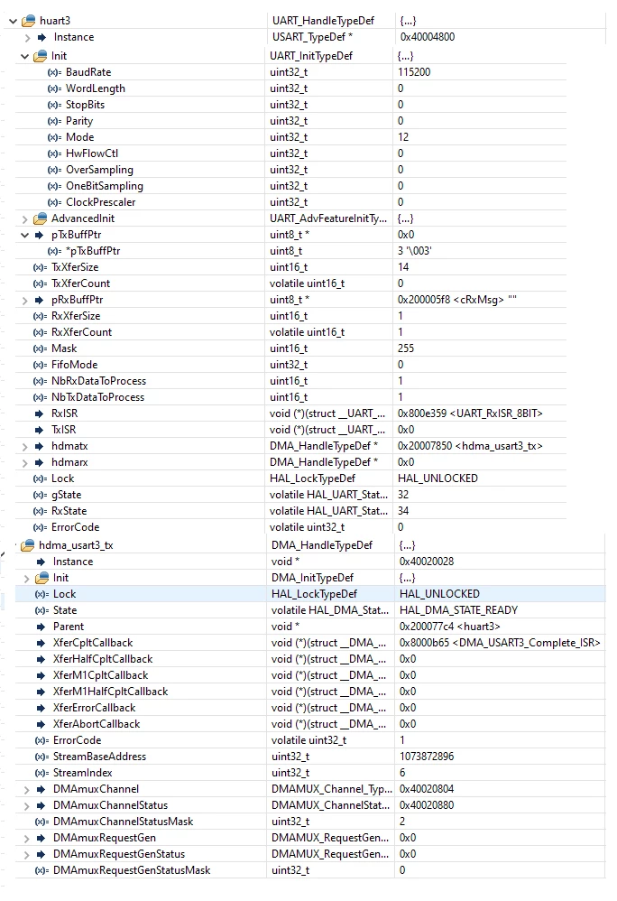

DMA to UART TX , code works on NUCLEO STM32H743 but not DISCO STM32H745
On both boards the UART/DMA in CubeMX is setup the same, with a DMA channel added for "USART3_TX". Comparing the generated USART and DMA initialization code, they are identical.
However, with the NUCLEO board, it transmits with either "HAL_UART_Transmit()" or "HAL_DMA_Start_IT()".
But on the DISCO board, it only transmits if using "HAL_UART_Transmit()", NOT "HAL_DMA_Start_IT()" nor "HAL_UART_Transmit_DMA()"
I verified that the DISCO is calling MX_DMA_Init to enable the DMA clock/NVICs.. just like the NUCLEO board, and all the HAL routines return "HAL_OK".
The only other difference is that the DISCO is a dual-core arm (CM7 and CM4), but I've disabled the CM4 but maybe there's some other caching , DMA/UART-TX domain issue?

All the HAL routines return "HAL_OK". I've tried downloading the NUCLEO project onto \the DISCO but it fails during the SystemClock_Config(). (The DISCO has a 25Mhz clock whereas the NUCLEO has an 8Mhz input clock). In both CUBEMX settings, the core and peripheral clocks are the same for both projects.
The address for the DMA -> UART TX source is a local variable, which seems like it could be an issue, but the NUCLEO board has no problem with it. However, Just to be safe, I made it a global, and it still works for the NUCLEO, and still does not work with the DISCO board.
strncpy ( cDbgMsg, "Ready USART3\r\n\0", strlen("Ready USART3\r\n\0") );
// Set DMA as source of UART Tx Buffer
huart3.Instance->CR3 |= USART_CR3_DMAT;
HAL_DMA_RegisterCallback ( &hdma_usart3_tx, HAL_DMA_XFER_CPLT_CB_ID , &DMA_USART3_Complete_ISR);
HAL_DMA_Start_IT (&hdma_usart3_tx , (uint32_t)(cDbgMsg), (uint32_t)&huart3.Instance->TDR, 10 ) ;
HAL_UART_Transmit_DMA ( &huart3 , (uint8_t*)(cDbgMsg), strnlen (cDbgMsg, 16) );
Looking at the pertinent DISCO Uart and DMA registers, it seems like the settings are all there:

Upon further investigation, after the HAL_DMA_Start_IT  call (HAL_OK), the DMA2_Stream0_IRQHandler interrupt fires! But apparently , inside that HAL ISR, it has a Transmit Error which is the reason why the DISCO's DMA USART TX Complete ISR is never called.

Seems the root problem is this declaration isn't placing the array into the D2 Memory , but rather DTCMRAM (0x20000080):
__attribute__ ((section(".SRAM2"), used)) ALIGN_32BYTES (uint8_t cTxBuffer[64]);
Despite the STM32H745XIHX_FLASH.ld linker script having the above SRAM2 section mapped to 0x30000000

 The NUCLEO has the same declaration and works fine.. Any idea why it's not mapping using the DISCO board?

In STM32CubeIDE you should right-click on project name -> Properties -> C/C++ Build -> Tool Settings -> MCU G/G++ Linker -> General and
unchek "Discard unused sectoins (-WI, --gc-sections)"
That worked for me
