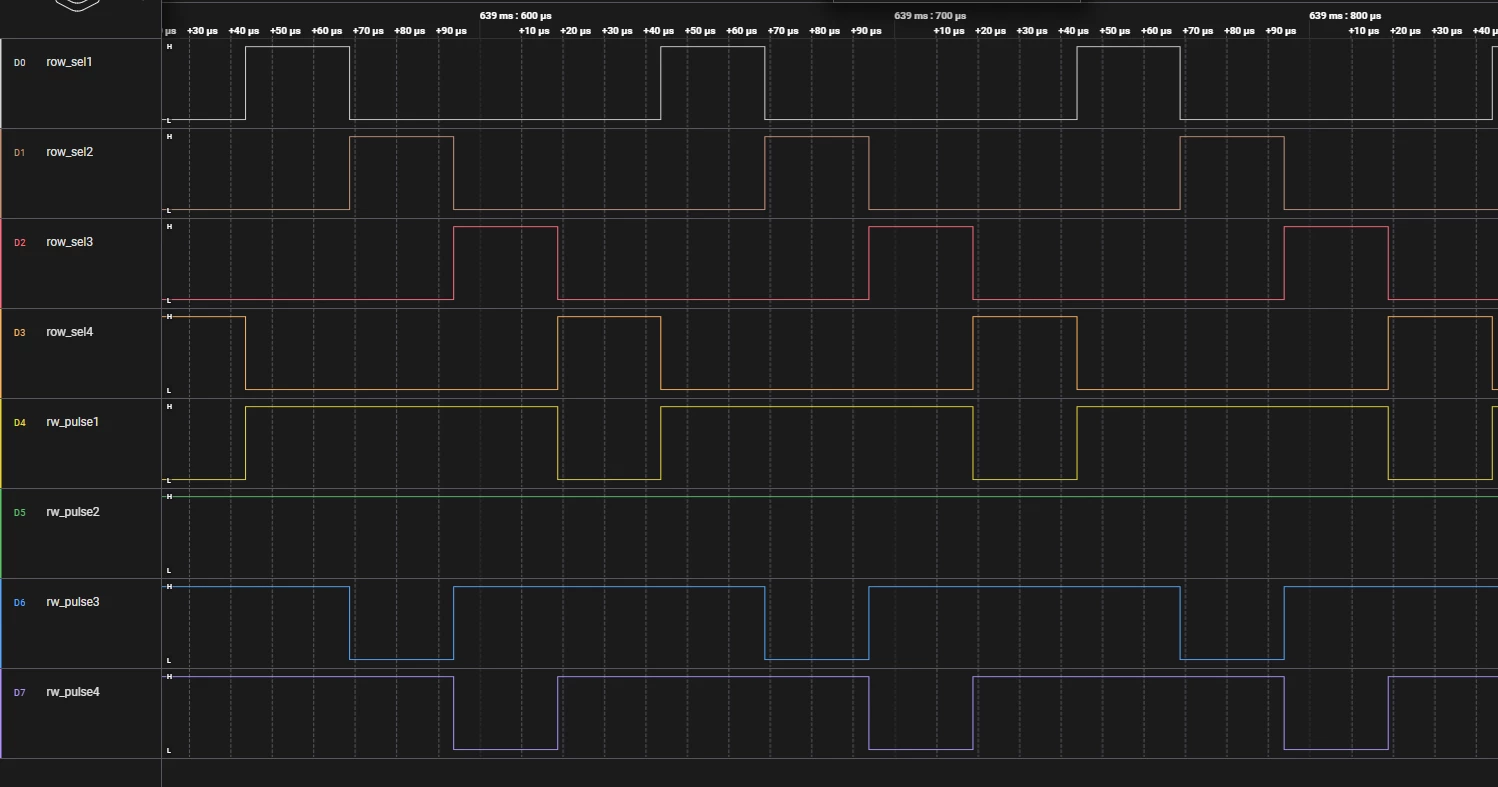

Hello!
I am using the STM32F446RE Nucleo Board and succeeded in sending a signal chain via DMA to the GPIO Bank B, i.e. the BSRR register.
The DMA trigger works very fine. However, one of the 8 signals is missing/not generated/skipped...
This is where I need help. I cannot figure out, why there is only one signal missing, "rw_pulse2", while all the others are generated correctly. (attached, a screenshot of the LA capture).

And the function that is responsible for the pattern generation and the DMA transfer:
void write_memristor(uint32_t cycles) {
static uint32_t row_pattern[8];
row_pattern[0] = SET_ROW_SEL1 | SET_RW_PULSE1 | RESET_ROW_SEL4 | RESET_ROW_SEL2;
row_pattern[1] = RESET_ROW_SEL1 | SET_ROW_SEL2 | SET_RW_PULSE2 | RESET_RW_PULSE3;
row_pattern[2] = RESET_ROW_SEL2 | SET_ROW_SEL3 | SET_RW_PULSE3 | RESET_RW_PULSE4;
row_pattern[3] = RESET_ROW_SEL3 | SET_ROW_SEL4 | RESET_RW_PULSE1 | SET_RW_PULSE4;
row_pattern[4] = SET_ROW_SEL1 | RESET_ROW_SEL4 | RESET_ROW_SEL2 | SET_RW_PULSE1;
row_pattern[5] = RESET_ROW_SEL1 | SET_ROW_SEL2 | RESET_RW_PULSE3 | SET_RW_PULSE2;
row_pattern[6] = RESET_ROW_SEL2 | SET_ROW_SEL3 | SET_RW_PULSE3 | RESET_RW_PULSE4;
row_pattern[7] = RESET_ROW_SEL3 | SET_ROW_SEL4 | RESET_RW_PULSE1 | SET_RW_PULSE4;
// Start the DMA transfer
HAL_DMA_Start_IT(&hdma_tim1_up, (uint32_t)row_pattern, (uint32_t)&(GPIOB->BSRR),8);
HAL_TIM_Base_Start_IT(&htim1); // Start the timer with interrupt
HAL_TIM_PWM_Start_IT(&htim1, TIM_CHANNEL_1);
HAL_TIM_PWM_Start_IT(&htim2, TIM_CHANNEL_1);
TIM1->DIER |= TIM_DIER_UDE; // Set UDE bit (update DMA request enable)
Thanks a lot!
Cheers,
Ruan!

Are you sure that the SB46 jumper is open on your NUCLEO-F446RE?
Regards
/Peter
January 3, 2024
Hello Peter,
both SB46 and SB52 are open, I just checked with a multimeter!
Thank you!
Ruan!
AScha.3
January 3, 2024
Just - is this sequence intentional: pulse 4312 - pin 6789 ? (not: 4321 )
January 3, 2024
Hey AScha.3,
the pinout was more or less arbitrary, as long as all the pins could fit in one GPIO Bank, in this case B.
Cheers!
waclawek.jan
January 3, 2024
Toggling PB9 in software (i.e. without DMA) works?
