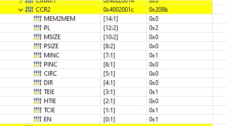

I'm trying to get the SPI communications to a peripheral handled by the DMA. I have reviewed the STM32L0 reference manual, and LL libraries, as well as close examples. I am able to get Tx operation working properly. However, I cannot get Rx to work. The Rx variable always shows as empty.
I have been trying this operation in loopback mode, with an external connection between MISO and MOSI. Whatever I send should end up in the receiver variable location. However, this does not happen. Instead, the Rx data variable never changes.
Can I get some insight here?

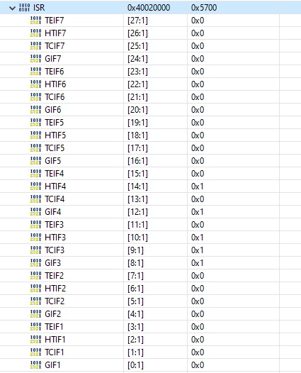

waclawek.jan
November 18, 2022
Polled SPI Rx works?
Read out and check/post content of SPI and DMA registers.
Dude
DudeAuthor
November 21, 2022

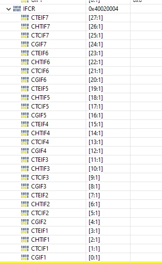

DMA1 -> ISR register
0693W00000WJ7Z1QAL.pngDMA1 -> IFCR register
DMA1 -> CCR2 Register
DMA1 -> CNDTR2 Register
0693W00000WJ7eYQAT.pngDMA1 -> CPAR2
DMA1 -> CMAR2

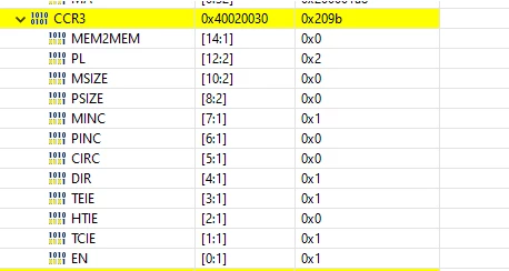

DMA1 -> CCR3

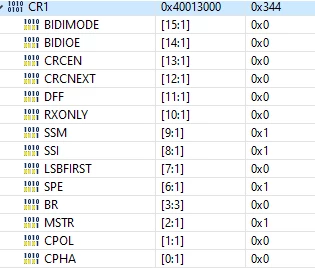

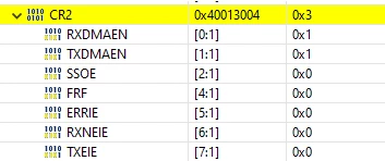

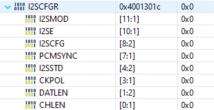

SPI Registers
SPI1 -> CR2
SPI1 -> SR
SPI1 -> DR
SPI1 -> CRCPR
SPI1 -> RXCRCR
SPI1 -> TXCRCR
SPI1 -> I2SCFGR
SPI1 -> I2SPR

Noticed Behavior:
  1. Polling the SPI peripheral works (no DMA)
  2. The Tx transmission transfer complete interrupt triggers.
  3. The Rx receive complete interrupt never triggers.
  4. Manually polling the SPI_DR register returns the correct information (or so it appears)
So in short
  1. The DMA is sending
  2. The SPI is receiving
  3. The DMA doesn't seem to be handling receiving from the SPI properly.
Dude
DudeAuthorBest answer
November 22, 2022
Discovered the problem: TIM2_UP conflicting with SPI1_RX in DMA Channel 2. Didn't notice the conflict as it extended over to the backside of the printout.
