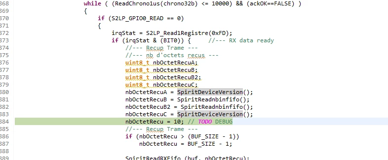

Hi everyone,
I'm currently working on project witch use SPi with DMA and S2LP Module

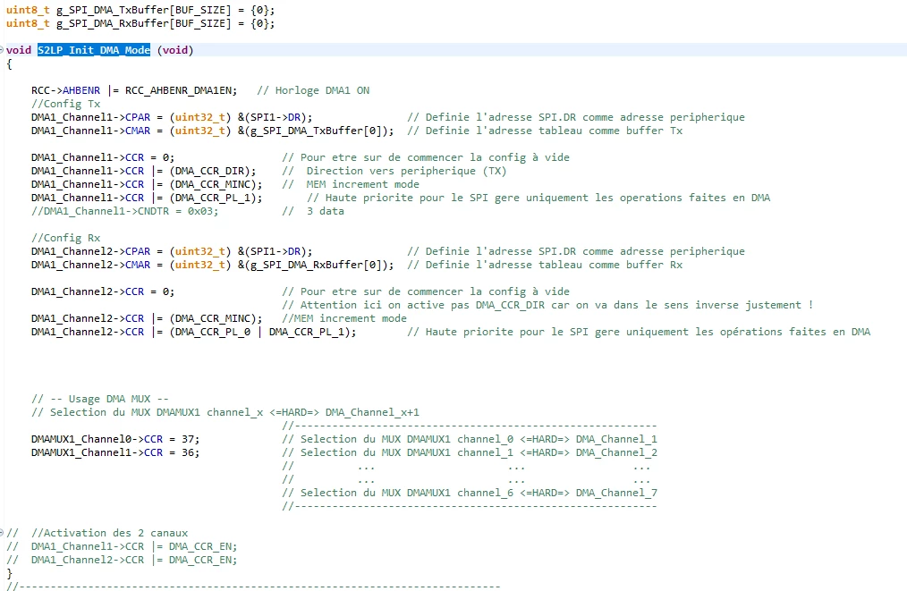

I have a function that initializes the DMA portion :
In my code I try to read information in DMA through the SpiritDeviceVersion and SpiritReadnbinfifo functions:
However, I get my data, but only when I call a DMA read 2 times :
nbOctetRecuB = the value I should read from nbOctetRecuA (0xC1)
nbOctetRecuB2 = the value I should read from nbOctetRecuB (0x0A, my FIFO element count)
nbOctetRecuC = the value I should read from nbOctetRecuB2 (0x0A, my FIFO element count) => whereas I expect 0xC1.
Below are one of those function:
I don't understand witch element is missing, why i need to perform another DMA operation to get my data ?
Just a heads-up, a double DMA operation is needed : so if I read S2LP register with DMA, and after Reread DMA without using SPI (ex no CS command) i get my data, this is what it tell me the problem isen't from the SPI ?
Is anyone get tis issue ?
Tanks for your time, Regards.

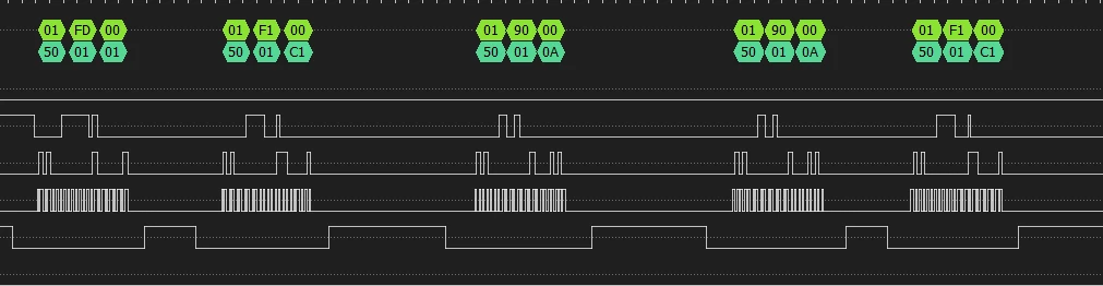

Have you used an oscilloscope or logic analyser to see what's actually happening on the SPI wires?
Quentin_27
Oct 20, 2025 11:37 AM UTC
Yes it works without DMA,
All is correct on SPI Wires as you can see below  (Last ligne is CS#, Frequency 1MHz, and I have try 4MHz):
Andrew Neil
Oct 20, 2025 11:49 AM UTC
Thanks for the LA screenshot.
Does it show the DMA or non-DMA case?
Do you see any differences?
Quentin_27
Oct 20, 2025 11:55 AM UTC
That's the problem, I havent any differences on SPI bus..

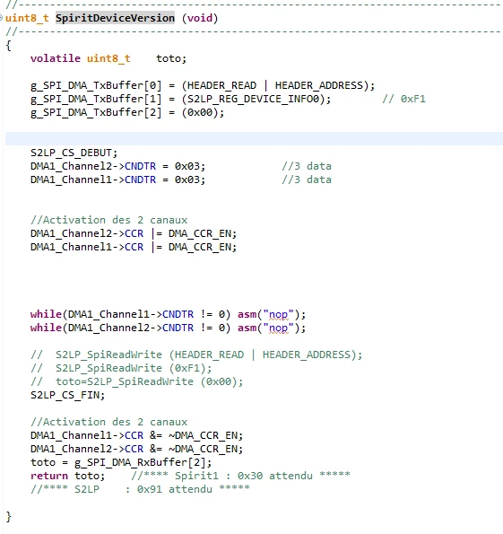

The Screenshot show the DMA-case , so when i'm using DMA actually, i need to do that to get my data and not the previous (SPI 1 time and DMA read 2 times):
uint8_t SpiritDeviceVersion (void)
	volatile uint8_t	toto;
	g_SPI_DMA_TxBuffer[0] = (HEADER_READ | HEADER_ADDRESS);
	g_SPI_DMA_TxBuffer[1] = (S2LP_REG_DEVICE_INFO0); 		// 0xF1
	g_SPI_DMA_TxBuffer[2] = (0x00);
	S2LP_CS_DEBUT;
	DMA1_Channel2->CNDTR = 0x03;			//3 data
	DMA1_Channel1->CNDTR = 0x03;			//3 data
	//Activation des 2 canaux
	DMA1_Channel2->CCR |= DMA_CCR_EN;
	DMA1_Channel1->CCR |= DMA_CCR_EN;
	while(DMA1_Channel1->CNDTR != 0) asm("nop");
	while(DMA1_Channel2->CNDTR != 0) asm("nop");
	//	S2LP_SpiReadWrite (HEADER_READ | HEADER_ADDRESS);
	//	S2LP_SpiReadWrite (0xF1);
	//	toto=S2LP_SpiReadWrite (0x00);
	S2LP_CS_FIN;
	DMA1_Channel1->CCR &= ~DMA_CCR_EN;
	DMA1_Channel2->CCR &= ~DMA_CCR_EN;
	//==========================2eme lecture==========================
//	while(DMA1_Channel1->CNDTR != 0) asm("nop");
//	while(DMA1_Channel2->CNDTR != 0) asm("nop");
	while (!(DMA1->ISR & DMA_ISR_TCIF2))
	 // NOP ou rien
	 asm("nop");
	DMA1->IFCR = DMA_IFCR_CTCIF2; // clear flag
	//==========================Fin 2eme lecture=======================
	toto = g_SPI_DMA_RxBuffer[2];
	return toto;	//**** Spirit1 : 0x30 attendu *****
	//**** S2LP : 0x91 attendu *****
I have try another flag to check DMA here but no difference.
