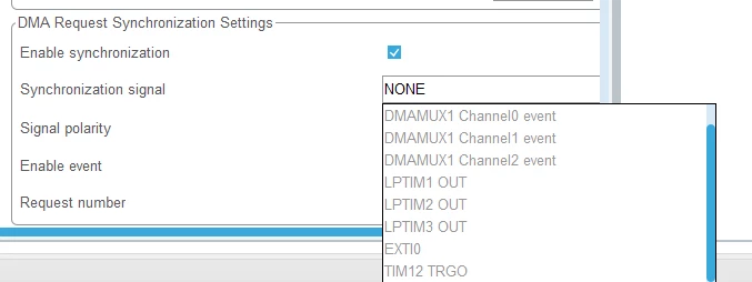

DMA Request Synchronization?
What does DMA Request synchronization do? In the case of SPI_Rx does it trigger SPI reception when TIM12 updates (overflow) if i set synchronization signal to be TIM12 TRGO
1 reply

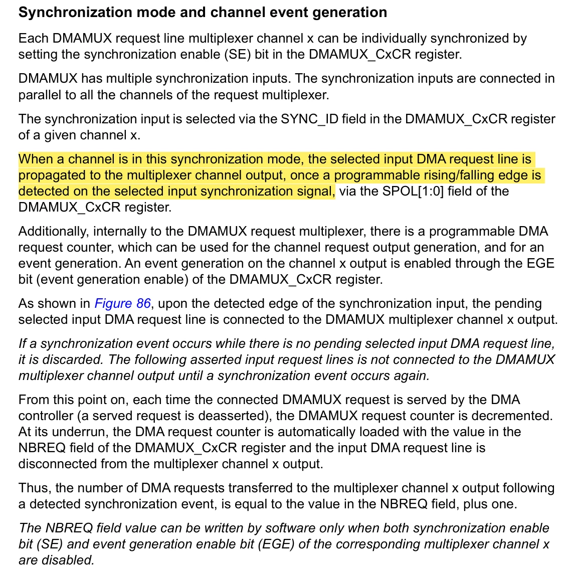

Nov 7, 2025 1:49 PM UTC
Yes. The Reference Manual, which is your best source for understanding how the chip works, goes over it in some detail. The DMA request is held until a sync event happens, in this case TIM12_TRGO, which is the timer update if TRGO is set to the update event.
