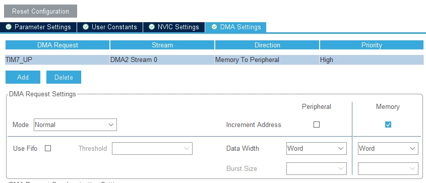

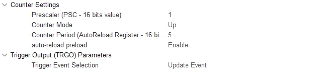

To do that I have to create a fairly fast burst of data with pulses of 0.6, 0.3  and 0.9 us.
To achieve this I set timer 7 to have an update even every 100nS then I set DMA2 stream 0 in memory to peripheral configuration.
The idea is to create a buffer, with the signal timing, and then set the DMA2 to transfer that buffer to the BSRR register of the port I have connected to the leds.
And it works, It generates the pulses every 100nS and then writting to the buffer where the sets and resets are I got my signal with pretty ok timing.
The problem is that it only works once.
Since I won't be updating the leds often, I don't want to create a circular buffer and load the DMA all the time. That's why I wanted to do a normal buffer, execute it once and execute it again when I need to change the colors.

If I put an interrupt before the while loop and set the logic analyzer to trigger, I get the signal sent once, perfectly done. But if I set the analyzer to trigger again the DMA just won't send the data anymore.
I tried clearing the interrupt flags of the DMA:
DMA2->HIFCR = 0x0FFFFFFF;
DMA2->LIFCR = 0x0FFFFFFF;
I read the status of DMA2 after the 10ms time
HAL_DMA_GetState(&hdma_tim7_up);
And its 2 HAL_DMA_STATE_BUSY = 0x02U, /*!< DMA process is ongoing */
I tried aborting after the 10ms
HAL_DMA_Abort(&hdma_tim7_up);
With no success.
Can you please explain to me why the DMA only transmits once?
Thank you very much

Hello @BRapo.1,
Here some support :
  • Why are you transferring an array of size 289 into a single register of 32 bits ? Have you enabled the source increment ? "If the increment mode is enabled, the address of the next transfer is the address of the
    previous one incremented by 1 (for bytes), 2 (for half-words) or 4 (for words) depending on
    the data width programmed in the PSIZE or MSIZE bits in the DMA_SxCR register." (extract of chapter 15 of RM0433, I advise you to read more by clicking here).
  • Also, how are you filling bf ?
  • Can you please share your DMA handler?
