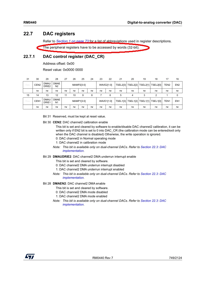

Maybe this?
But I'm not sure.
Read out and post DMA and DAC registers content at the moment of failure.

Oh yes, you are right.
I changed the peripheral size in DMA register to 32Bit and now it works! :party_popper:
Thank you so much.

In most STM32, the vast majority of peripherals are behind an AHB-to-APB bridge, and that bridge silently converts "inappropriate" accesses, e.g. "doubles" halfword writes (copies lower halfword to upper halfword) so it probably never signals error on the AHB side.
The 'G4 is weird in that DACs are on AHB, not APB; that might explain that this indeed caused a bus error. I wonder whether attempt to write halfword from processor would throw the processor to fault. Can you please try
*(volatile uint16_t *)&dac.DHR12R1 = 500;

The change to 32Bit solved the problem. I have tryed it.
This line of code leads to an error. So it really seems that the 16Bit access was the problem.
