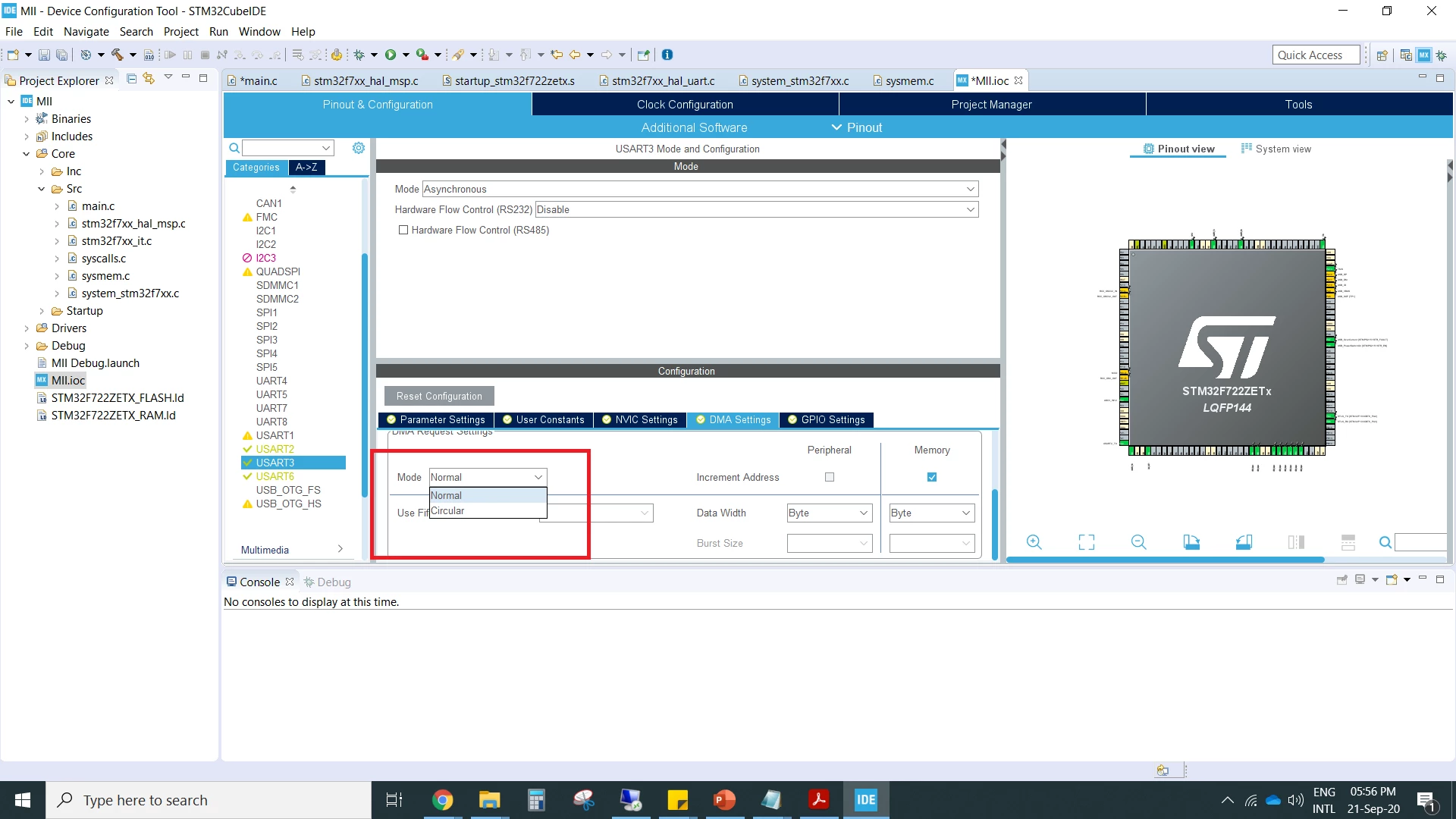

Hello, what's the difference between the "Normal" and "Circular" modes of the STM32 DMA ?
As far as I understand - "Circular" will write to the first address, auto increment the address to the next one until the last address is reached and then return to the first address.
Is this is correct ?
If yes, how will "Normal" mode behave ?
Roughly yes, For details read the DMA chapter in RM.
After last transfer, it disables itself.

So normal it will issue a single interrupt every time the function is called ?
And circular has to be called only once and it will remain on ?
Depending on how you enable it in the control register, there will be one Half-Complete and one Transfer-Complete interrupt.
I'd say *enabled* rather than *called*, but basically yes, unless you disable it or a Transfer Error occurs.
