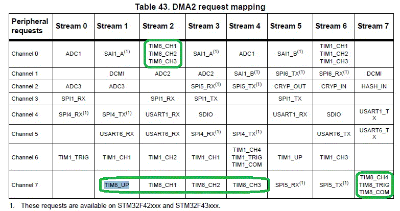

Thank you very much for posting this example - I'm not exactly sure how to proceed, however.  I am building a custom data logging system for my next offroad vehicle that will be used to log accelerometer readings, speed, GPS position, wheel speeds, suspension travel, engine operating parameters, etc.  I'm attaching a parallel ATA or CompactFlash (unsure which at this point, though they're logically very very similar) solid state storage unit of approximately 16-64GB size to an STM32F series MCU.  Port E is routed to the D0-D15 lines, #IORD/#IOWR to a few GPIO pins (since my fallback if I can't get DMA working is to use PIO mode) and now I'm trying to figure out how I should connect my DMARQ and #DMACK pins to Timer 8 on the STM32F so the DMA controller can handshake with the drive properly.  The way P-ATA/CF/IDE DMA handshaking works is that the controller initiates a DMA transfer command by writing command parameters to several registers over the bus, then the storage device requests the first word by activating DMARQ.  The microcontroller then needs to respond by driving data onto port E, waiting the setup time, then activating #DMACK and the appropriate #IORD or #IOWR signal (depending on which way the data is flowing... in my case, writing).  Once the #DMACK signal activates, the storage device receives or transmits the data, then reactivates DMARQ to request the next transfer as required.
I may need to add external glue logic for #IORD/#IOWR, I think.  But my major question is - which external signals on Timer 8 do I use as DMARQ/#DMACK so this will all work?  Is there any way to do it?  Reading the software reference manual and your example cleared things up a bit, but I'm still not really sure what signals I should be using here.  Once I know that, I can finish laying out my PCB artwork, build the board, and worry about writing the software if PIO mode ends up being a bottleneck.

Posted on June 12, 2014 at 03:03
I guess you might want to ponder MicroSD (SDHC/SDXC) cards, the interface is clockable in the 24-37 MHz region, and writing large blocks (32KB) via FatFs isn't particularly slow (I'd expect >10MBps)
For TIM8 the channels/streams are defined in the Reference Manual RM0 The specific pin designations for the channels can be found in the
http://www.st.com/st-web-ui/static/active/en/resource/technical/document/datasheet/DM00037pdf
for the specific part.
The lack of a proper ACK/REQ DMA interface is one of the missed opportunities in the STM32 designs.
