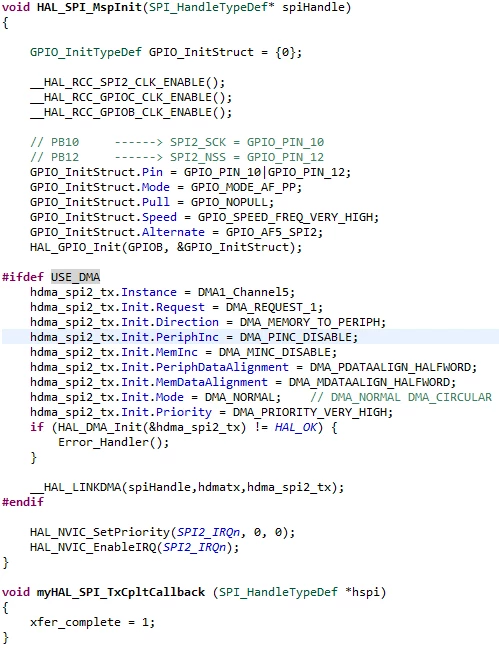

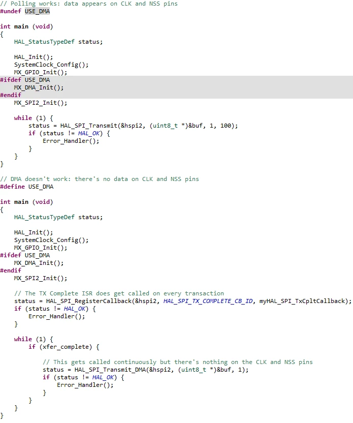

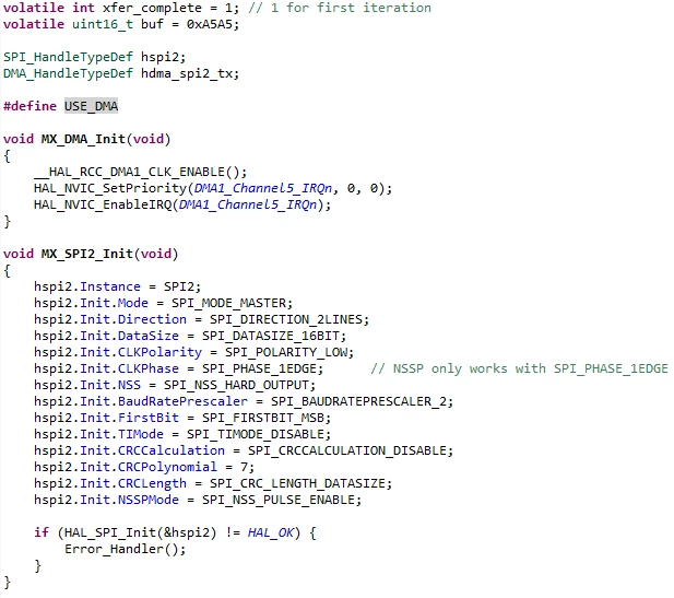

SSoCalJimAssociate III1 year agoJanuary 13, 2025QuestionDMA memory to SPI is not working1 reply579 viewsI can get HAL_SPI_Transmit (and HAL_SPI_Transmit_IT) to work properly, but I cannot get HAL_SPI_Transmit_DMA to output signals. Here's my simplified code. DMASTM32L4 seriesSPI
