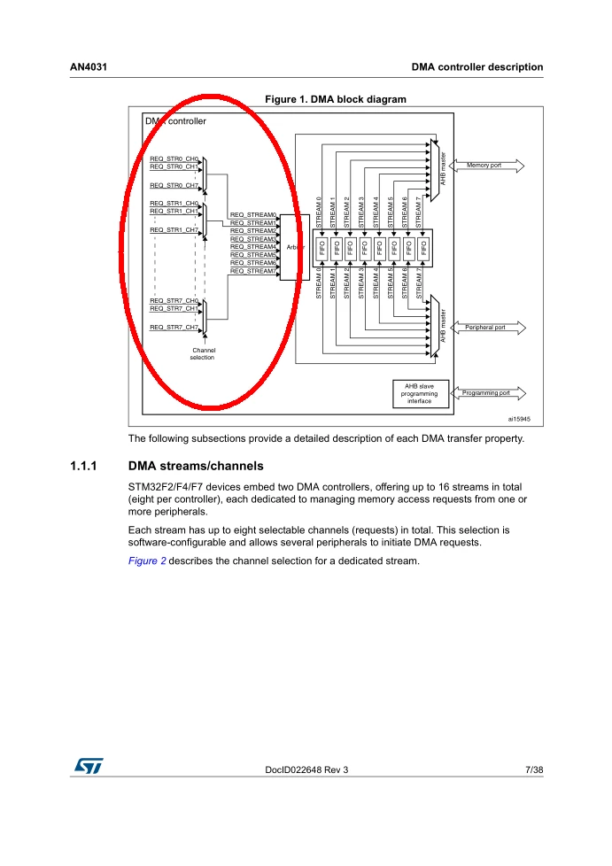

I have a doubt regarding DMA memory to peripheral ?
Suppose I would like to transfer a memory buffer content to SPIx TX.
When do each transfer occurs ? Every time I change the content of the memory buffer ? Always ?
I cannot find this information into the TRM.
Regards,
s.
1 reply
waclawek.jan
October 9, 2019
Each time there is a request .
0690X00000ApLY1QAN.pngJW
simo zzAuthor
Senior
October 9, 2019
Oh, what a fool.
I understand that this is a matter of enabling / disabling the stream.
Thanks.
