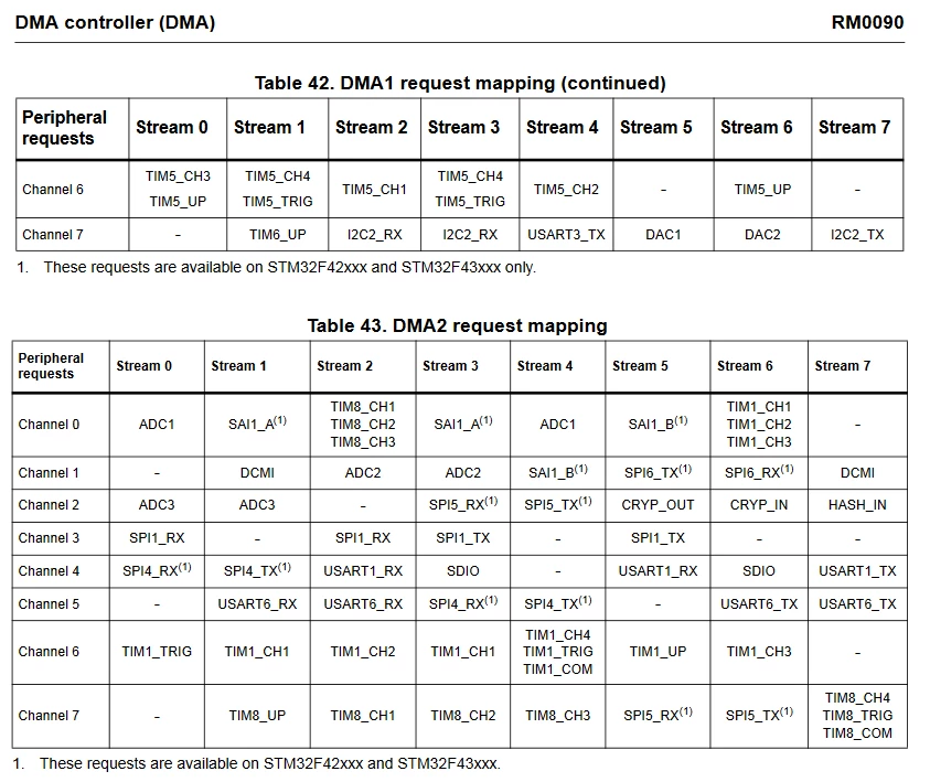

What is the meaning of These requests are available on STM32F42xxx and STM32F43xxx only for DMA1 and These requests are available on STM32F42xxx and STM32F43xxx for DMA2.
What should ı use for the mapping ?

Which channel should I choose for transferring CDR register data?
CDR on which ADC? as I said, each one has its channel and stream as shown in the table.
@tinkerer_of_universe wrote:
Does this sentence have no relevance to STM32F407
This note is related to some peripheral mappings:
So these requests are available only on STM32F42xxx and STM32F43xxx products.

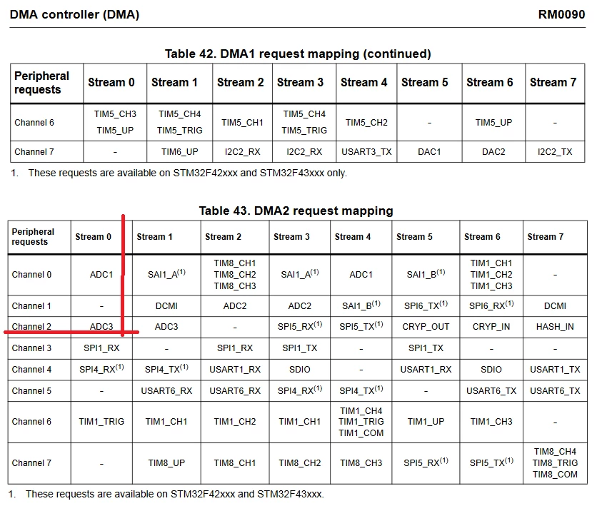

Hell @tinkerer_of_universe and welcome to the community,
For example, if you want to trigger DMA transfer using ADC3 end of conversion, you need to select Stream 0 / Channel 2.
Example from HAL:
hdma_adc.Instance = DMA2_Stream0;
hdma_adc.Init.Channel = DMA_CHANNEL_2;

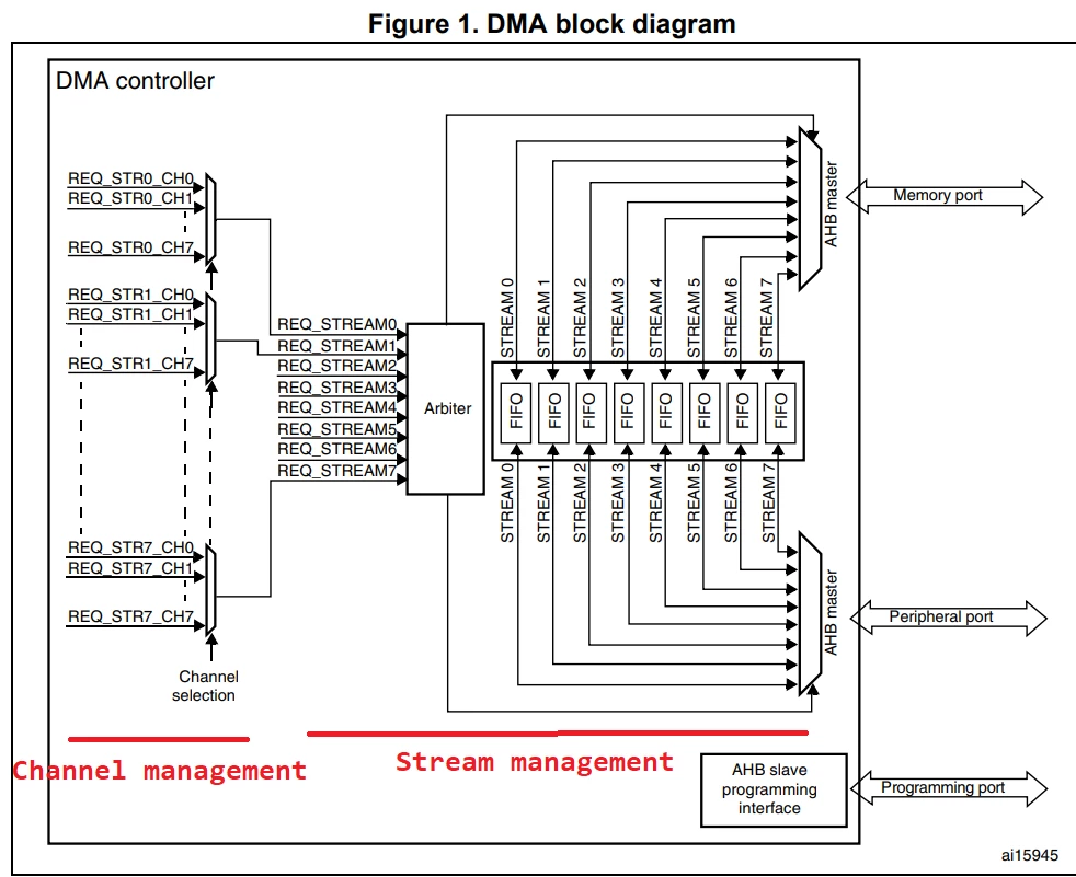

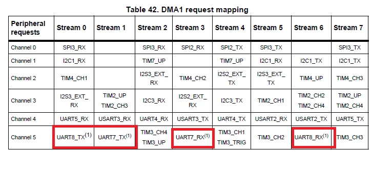

For more details, please review the AN4031  "Using the STM32F2, STM32F4 and STM32F7 Series".
DMA controller
Figure 1. DMA block diagram
