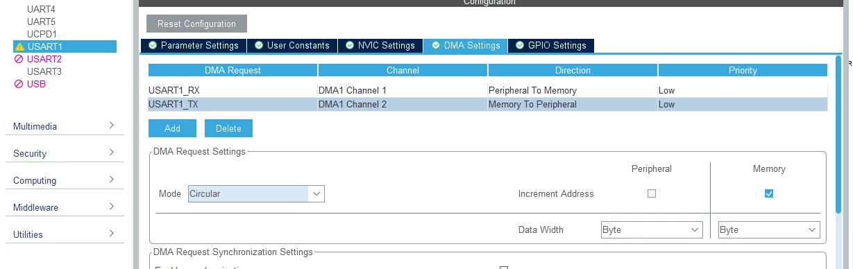

DMA keep sending data
Hi all,
I want to send 3 bytes with the UART DMA controller
but when this line is executed, the uart sends these 3 bytes endlessly .
Why does the transmitting not stop after 3 bytes ?
HAL_UART_Transmit_DMA(&huart1,(uint8_t *)spi_buf_in,3);
Thank you

TDKBest answer
September 13, 2021
Perhaps the DMA is somehow in circular mode.

Don't know. Is this the only line in the program, or do you configure the DMA and associativity somewhere, or have related call-backs?
Any particular STM32?
