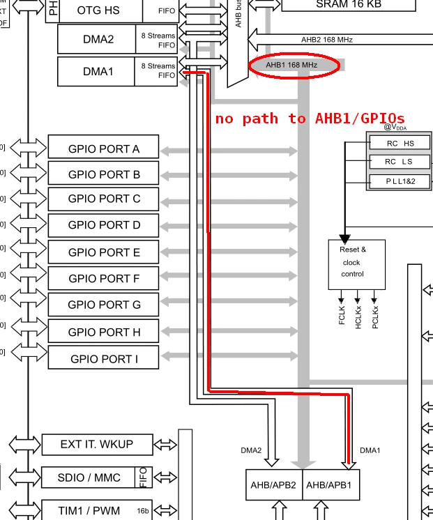

Hi all,
i'm having issue with DMA on STM32F417, i have configuration DMA1_Stream1 is having trigger updates from TIM6_UP (Channel7),
i get after start TIM6 error TEIF1 :(
my source code was functional with configuration:
DMA2_Stream1 Channel7 + TIM8_UP :(
please could you review my sources: ?

    You'll probably want to be using DMA2 to transact with a peripheral on AHB1, which would be classified as a Memory-to-Memory

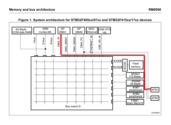

    DMA1 and DMA2 have multiple streams
    To rephrase, DMA1 talks between peripherals on APB1 and memory. It won't talk to peripherals on APB2 or AHB1 (GPIOE)
    AHB1, APB2 and Memory are classified as ''memory'', only DMA2 permits memory-to-memory transfers.

    This should be in the datasheet and Reference Manual.
    waclawek.jan
    Sep 19, 2017 4:52 PM UTC
    Posted on September 19, 2017 at 16:52
    Well, it is.
    It's repeated as a footnote at the DMA block schematics in the DMA chapter.
    That GPIOs are on AHB1 is in Table1.
    Both facts can be seen from the block diagram in the DS, too.
