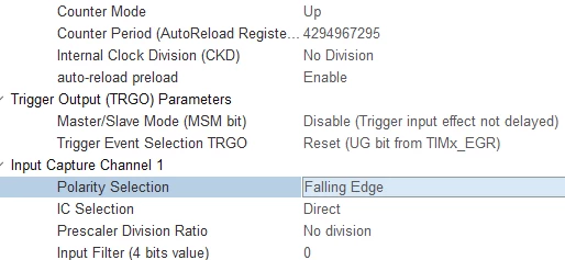

After setting configuration registers in HAL_DMA_Start_IT, DMA fails to fire back interrupt, HAL_DMA_IRQHandler(). The TransferComplete call back routine is not called but only once after reset since HAL_DMA_IRQHandler() is called only once after initialization. Flags CC1DE and CC1IE are set after initialization and never change there after. I am trying to read a parallel ADC through GPIO using DMA with interrupt and timer input capture. I am using STM32L496ZG ucontroller and used CUBEMX to generate code.
Also, I am using Timer2 with input capture mode to request DMA transfer. And using MCO to generate 2 MHz to feed to PA0 for timer2 ch1.
I searched the forum and checked almost everything. I used latest  CUBEMX 6.11.1 version.
Your help is greatly appreciated.
Thanks

Klassic_0-1718361144991.png           DMA Req setting: >Mode: Normal.

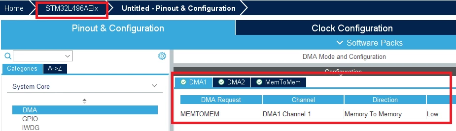

mƎALLEm
Jun 14, 2024 10:47 AM UTC
As you need to transfer data from GPIO IDR to a memory, how did you configure the DMA? Peripheral to Memory? If yes this that's not the correct config.
You need to consider the GPIO register as a memory location so you need to configure it as Memory to Memory.
You can also refer to this application note AN4666.
Read also this post: https://community.st.com/t5/stm32-mcus-products/stm32f429-read-from-pin-to-dma/m-p/683278
Klassic
KlassicAuthor
Jun 14, 2024 11:54 AM UTC
Thanks SofLit,
As you know there's no Mem to Mem option available in recent cubeMx. Only Periph to Mem Or Mem to Periph. I read somewhere that Periph to Mem is same as Mem to Mem. plz correct me.
According to AN4666 doc, DMA1Ch5 was selected using Tim2Ch1. And I did the same.
For timer in Inp capture, I am using falling edge to trigger DMA.
Thanks

waclawek.jan
Jun 14, 2024 2:06 PM UTC
Is the DMA set to Circular? If not, how do you start it again?
Klassic
KlassicAuthor
Jun 19, 2024 5:52 AM UTC
Hi jan,
Sorry for late reply. I was working to put changes suggested by SofLit and DMA setting to circular, but could not succeed. DMA is set to normal.
Also, I could not accommodate MEM to MEM DMA change, as I could not connect interrupt trigger by timer with DMA.
  Still struggling to get it work.
Thanks
Klassic
KlassicAuthor
Jun 24, 2024 6:29 PM UTC
Hi  @mƎALLEm
   Tried DMA in MEM to MEM mode and triggered it thru software. And chose DMA2 for it. Still the DMA transfer happens only once during start up.
 Also, the mode is set to Normal instead of circular , since, according to RM, it cannot be set to Circular in Mem to MEM mode.
waclawek.jan
Jun 24, 2024 6:58 PM UTC
1. DMA M2M mode is not triggered by the usual requests from peripherals. Immediately after enabling it performs the number of transfers set in DMA Stream's NDTR, and ends. That's all.
2. Contrary to what @mƎALLEm said above, P2M *is* the correct mode, if you want to trigger individual transfers from the timer. However, in 'F4, only DMA2 can access the AHB bus where GPIO is located, and only TIM1 and TIM8 can trigger DMA2 streams. [EDIT] Sorry, this is irrelevant to this thread, as the 'L496 is used here, I mis-read the STM32 model.[/EDIT]
3. Cube may or may not get into your way when setting up this, as Cube/CubeMX inevitably caters only for a fraction of actions what the hardware allows, whatever Cube's authors deemed "usual", and this sounds to be "not usual". Disclaimer: I don't use Cube.

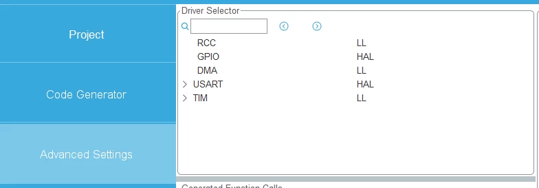

waclawek.jan
Jun 26, 2024 10:11 AM UTC
> Can you elaborate this ?
> How to make TIM1 to trigger DMA2 transfer?
Sorry, I mis-read the STM32 model you are using.
In 'L496, both DMAs can access GPIOs, but Cube/HAL and CubeMX probably don't support timer-triggered transfers between arbitrary addresses in the memory space. You may need to use register-level programming for that, or some workaround.

Klassic
KlassicAuthor
Jun 26, 2024 12:19 PM UTC
Oh thats bad news.
Klassic
KlassicAuthorBest answer
Aug 30, 2024 3:09 PM UTC
Seems like HAL libraries have still loop holes to be fixed. Jan, you are right.
I used LL library for Timer1 along with DMA and it worked. I can see the change in GPIO inputs during debug.
Thanks for supporting me.
