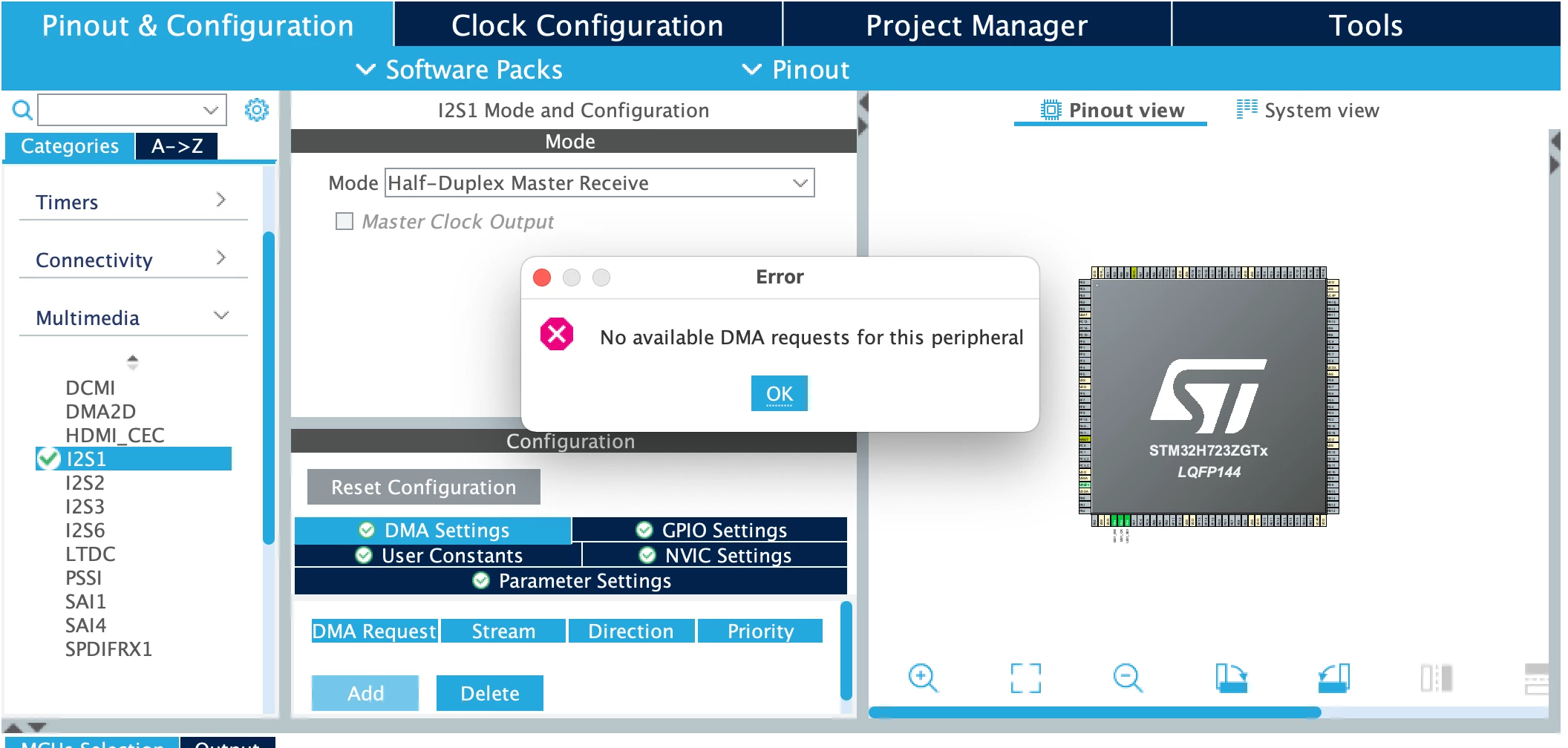

DMA I2S not working (STM32H723)!!!!
I tried everything but keep on running on the same issue:
0693W00000FC9HAQA1.pngIn the reference manual it describe the DMA for the I2S, so I'm quite sure it is possible to enable it.
Please help me.

Indeed, It is the latest version. I am facing the same issue than yours. DMA is for sure usable even for the half duplex mode.
I am going to see to rise up this issue.
In between, you can set-up the DMA like described in SPI HAL library examples embedded into the STM32H7 firmware library.

Which is the version of CUBEMX you have in your own ? Is it the latest ?

It is the 6.3.0. It should be the latest.

Is the update release date already known? I'm having the same problem...

I add confirmation that this point had already been highlighted and analyzed with a validated fix forcasted for next revision 6.4 of CUBEMX.
