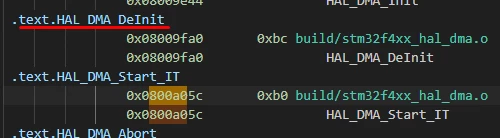

I am using STM32F401, I had an application which communicates via USART1 by using DMA2. Both RX and TX DMAs are working fine. So I added a bootloader and moved application to 0x08008100. Bootloader is using same USART1 and DMA2. Now bootloader is working fine but I have problem with application.
All I changed in application is start address. Bootloader jumps to application, timer interrupt is working fine and toggles LED. When it receives or transmits a data via DMA it stops, LED is not toggling anymore. When debugging I tried these:
* SCB->VTOR is already set as 0x08008100. Timer interrupt is working fine.
* I changed application's start address back to 0x08000000 and its working fine.
* I removed USART and DMA code from bootloader so it only jumps to application. It didn't solve the problem (it lloks like not deinitialize-initialize issue).
* I added USART and DMA to bootloader back. In the application I didn't use DMA when sending data with USART, it could send without any problem. I tried this a few times, it stops when sending data with USART DMA but keeps working when sending without DMA.
* In the application, I added HAL_DMA_DeInit before HAL_DMA_Init, it stops before even trying to send message.
How can I solve this issue? Thank you.

Sorry I meant its stuck in somewhere, is it possible to debug application code when using bootloader? I tried with bootloader now and I saw this error:
which means its in Hard Fault handler:
When I check call stack I see:
It fails in HAL_DMA_DeInit function. I was calling this function before initialization of DMA. I removed it.
After removing It keeps toggling LED but transmits data only once, then it doesn't send data (in the timer interrupt, I send test byte and toggle LED). Actually this was the my earlier problem, to solve it I added and removed many things (like HAL_DMA_DeInit ) whole day and forgot root cause. So I can summarize the issue: After jumping to application I send data with HAL_UART_Transmit_DMA function, data is sent once.

TDKBest answer
October 7, 2025
Can VTOR be set to multiple of 0x100? Seems small. Pretty sure it needs to be a multiple of 0x200.
Should be able to debug the application in STM32CubeIDE at whatever offset you have it at, step through, see the issue.
alig_onesAuthor
October 7, 2025
That was the problem, with 0x200 offset its working fine again, thank you very much @TDK and @Andrew Neil . I am using VS Code (it has useful features like git history, file timeline, code snippets, finding files functions etc.) but have less debug features unfortunately. I will try to use STM32CubeIDE. Thanks again.
