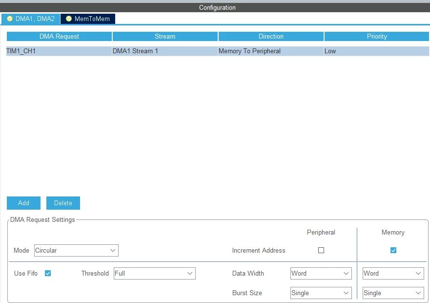

I am trying to use DMA to control GPIO port E output.
Below is configuration of CubeMX
0693W00000GW8rQQAT.pngIn Cortex-M4 context of dual core , DMA is successfully working to toggle GPIO Port E output .
But In Cortex-M7 context of dual core , although error message, DMA is not working.

 uint32_t _gTriOutState[2] = {0x0000FFFF,0xFFFF0000 };
 __HAL_TIM_ENABLE_DMA(&htim1, TIM_DMA_CC1);
 //__HAL_TIM_ENABLE_DMA(&htim1, TIM_DMA_CC2);
 HAL_TIM_Base_Start_IT(&htim1);
 HAL_TIM_PWM_Start(&htim1,TIM_CHANNEL_1);
 HAL_Delay(15);
 if (HAL_DMA_Start(&hdma_tim1_ch1, (uint32_t)&_gTriOutState, (uint32_t)&(GPIOE->BSRR),2) != HAL_OK)
 Error_Handler();

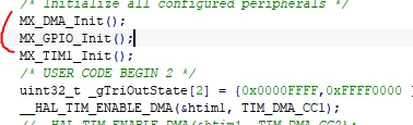

Hello @hryu.1​ and welcome to the Community :)
Please update the line MX_DMA_Init(); before MX_GPIO_Init().
This is a known issue (when using CubeMx v6.3.0) with the DMA initialization which should be before any other peripheral initialization .
This limitation will be fixed in the next release of CubeMx.
Hope this solve your issue.
When your issue is solved, please close this topic by choosing Select as Best. This will help other users find that answer faster.
Imen
hryu.1
hryu.1Author
November 2, 2021
as you suggested, I did it. But it is not working in Cortex-M7 .

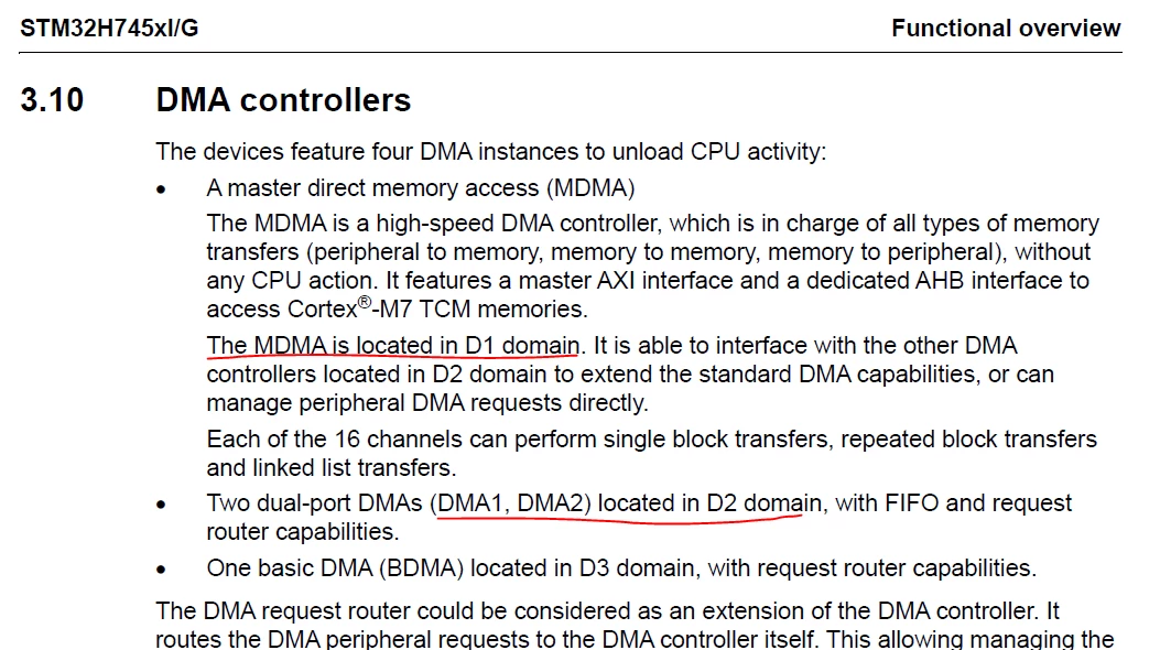

is it impossible technically to use DMA1, DMA2 in Cortex-M7?
hryu.1
hryu.1Author
November 2, 2021
Do I use MDMA instead of DMA1,DMA2?
If i have to use this,Please, let me know how to use it?
STM32H745xI/G datasheet ​
November 2, 2021
The problem is maybe related two things: memory layout on STM32H7 and internal data cache (D-Cache) of the Cortex-M7 core.
Please have a look at this FAQ: DMA is not working on STM32H7 devices.
I'll be waiting for your progress=)
