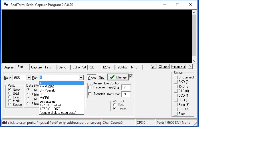

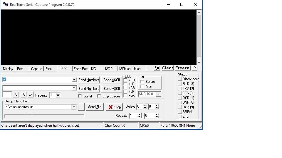

is not getting invoked and hence I do not see the LED getting Toggled :( Also attach here is the Screenshot of RealTerm Settings (1) and thesend tab in RealTerm, where I try to send a character (2). (1) 0690X00000605JCQAY.png (2) 0690X00000605GOQAY.png Thank you for your help. #solved #stm32
