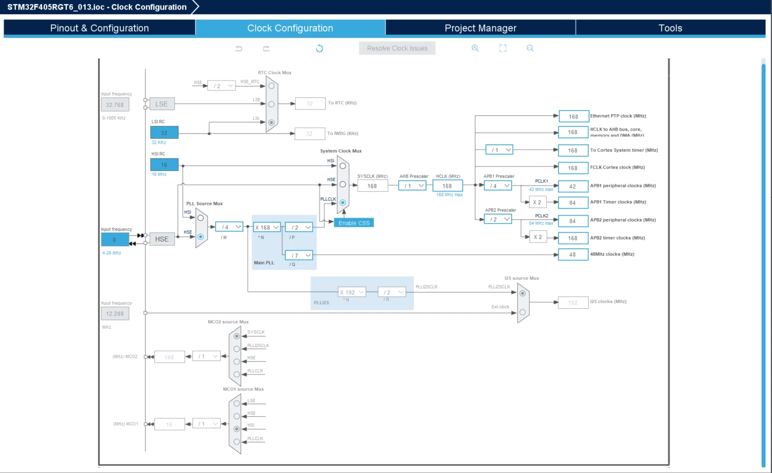

DMA DAC STM32F405RGT6 underrun
We have STM32F405RGT6 and we want to implement DAC through DMA.
We used an example for STM32F429ZI-Nucleo
Here is an actual code where we have an underrun the error and we need help to clarify reason and find a solution, thanks!:

void Configure_TIM_TimeBase_DAC_trigger(void)
 uint32_t timer_clock_frequency = 0; /* Timer clock frequency */
 uint32_t timer_prescaler = 0; /* Time base prescaler to have timebase aligned on minimum frequency possible */
 uint32_t timer_reload = 0; /* Timer reload value in function of timer prescaler to achieve time base period */
 if (LL_RCC_GetAPB1Prescaler() == LL_RCC_APB1_DIV_1)
 timer_clock_frequency = __LL_RCC_CALC_PCLK1_FREQ(SystemCoreClock, LL_RCC_GetAPB1Prescaler());
 else
 timer_clock_frequency = (__LL_RCC_CALC_PCLK1_FREQ(SystemCoreClock, LL_RCC_GetAPB1Prescaler()) * 2);
 timer_prescaler = ((timer_clock_frequency / (WAVEFORM_TIMER_PRESCALER_MAX_VALUE * WAVEFORM_TIMER_FREQUENCY_RANGE_MIN)) +1);
 timer_reload = (timer_clock_frequency / (timer_prescaler * WAVEFORM_TIMER_FREQUENCY));
 LL_APB1_GRP1_EnableClock(LL_APB1_GRP1_PERIPH_TIM6);
 LL_TIM_SetPrescaler(TIM6, (timer_prescaler - 1));
 LL_TIM_SetAutoReload(TIM6, (timer_reload - 1));//83
 LL_TIM_SetCounterMode(TIM6, LL_TIM_COUNTERMODE_UP);
 LL_TIM_SetTriggerOutput(TIM6, LL_TIM_TRGO_UPDATE);
 LL_TIM_EnableCounter(TIM6);

void SystemClock_Config(void)
 LL_FLASH_SetLatency(LL_FLASH_LATENCY_5);
 while(LL_FLASH_GetLatency()!= LL_FLASH_LATENCY_5)
 LL_PWR_SetRegulVoltageScaling(LL_PWR_REGU_VOLTAGE_SCALE1);
 LL_RCC_HSE_Enable();
 while(LL_RCC_HSE_IsReady() != 1)
 LL_RCC_PLL_ConfigDomain_SYS(LL_RCC_PLLSOURCE_HSE, LL_RCC_PLLM_DIV_4, 168, LL_RCC_PLLP_DIV_2);
 LL_RCC_PLL_ConfigDomain_48M(LL_RCC_PLLSOURCE_HSE, LL_RCC_PLLM_DIV_4, 168, LL_RCC_PLLQ_DIV_7);
 LL_RCC_PLL_Enable();
 while(LL_RCC_PLL_IsReady() != 1)
 while (LL_PWR_IsActiveFlag_VOS() == 0)
 LL_RCC_SetAHBPrescaler(LL_RCC_SYSCLK_DIV_1);
 LL_RCC_SetAPB1Prescaler(LL_RCC_APB1_DIV_4);
 LL_RCC_SetAPB2Prescaler(LL_RCC_APB2_DIV_2);
 LL_RCC_SetSysClkSource(LL_RCC_SYS_CLKSOURCE_PLL);
 while(LL_RCC_GetSysClkSource() != LL_RCC_SYS_CLKSOURCE_STATUS_PLL)
 LL_SetSystemCoreClock(168000000);
