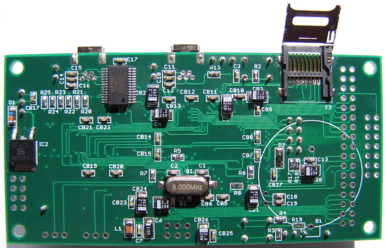

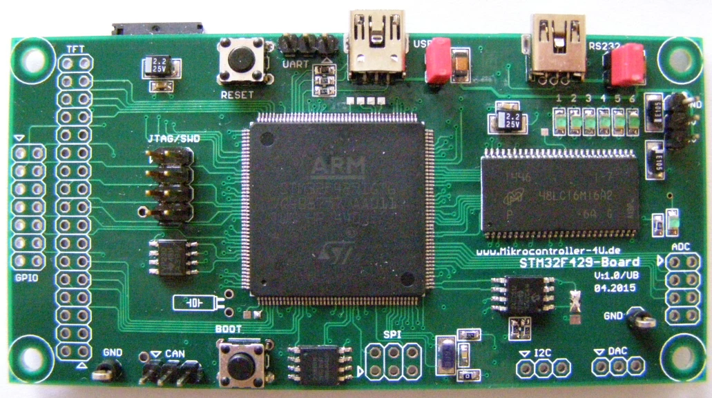

hello,
i would like to introduce my self-made Evaluation Board
for a STM32F429IGT6 (176 Pin LQFP)
pictures are attached
it's a 4 Layer 100mm x 50mm Board with onboard :
256MBit SDRAM
512kBit I2C-EEprom
16MBit SPI-Flash
CAN-Transceiver
FTDI-UART-Interface
Mini-USB for USB-OTG
Micro-SD-Card Connector
Six Status LEDs
And 2,54mm Header for many GPIOs and a 24bit TFT-Connector
(a second board for interfacing a 4,3 inch TFT is following)
here a link to my projectpage with further informations (only in german)
http://mikrocontroller.bplaced.net/wordpress/?page_id=4908

Interesting. Even has 2 terminals for the ground clip of a VO meter or 'scope.
Does 1 row of the JTAG/SWD pins match the 4 pin SWIM in ST-Link V2 ?
Cheers, Hal
mc-4u
mc-4uAuthor
May 19, 2015
Posted on May 19, 2015 at 16:35
no, an adapter cable is needed
check theattached schematic
