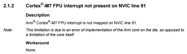

I'm digging into the FPU of a STM32H743 (Nucleo board, Keil IDE).
I've checked that the FPU is enabled in register CPACR.
I've compiled the following dumb code:
volatile double test = 0;
test = 1.0 / test;
If I look at the assembly I've got:
VDIV.F64 d0,d1,d0
where d1 contains the double representation for 1, d0 contains the double representation for 0.
After the instruction d0 contains
0x7F00...00
which is a representation for infinity, so the result is consistent.
However the flag DZC in register FPSCR is not set, as I was expecting it would be.
Am I missing something ?

See this item in the errata
Gpeti
GpetiAuthor
Senior
Jun 2, 2020 9:24 AM UTC
Oh my god ! Thank you, completely missed this point. I usually look to the errata for peripherals but I forgot there can be errors in the core itself...

How do you examine FPSCR?
Because when I just look at it in the CubeIDE register view while single-stepping a division by zero, sometimes the debugger forgets to update its value in the view.
When the code reads it via __get_FPSCR() after a division by zero, bit 1 is always correctly set.
The interrupt handler is never called.
When I change the debugger probe setting from ST-Link GDB Server to OpenOCD, it always updates the value of FPSCR.

I'm using Keil debugger. But it's a very good tip, I will try it ASAP.
Gpeti
GpetiAuthor
Senior
Jun 3, 2020 6:49 AM UTC
Berendi, you were exactly right.
Reading FPSCR from the executable (through CMSIS function, using instruction VMRS) returns 0x00000002 ie. bit DZC set.
Reading from the debugger FPU tab returns 0 (System Viewer tab).
More confusing, Keil provides another way to read FPSCR, from the Registers tab where the output is correct.
I assume this debugger inaccuracy might be linked to the Cortex FPU implementation error mentioned in the STM32H7 errata sheet ?

Or it might be the lazy stacking feature, if the debugger is using interrupts to handle breakpoints. Check the lazy stacking bit in FPU->FPCCR, or try to clear it.
FPU->FPCCR &= ~FPU_FPCCR_LSPEN_Pos;__ISB();
