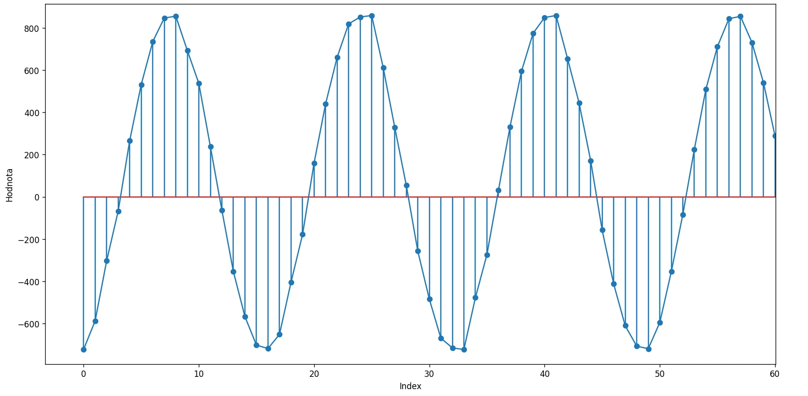

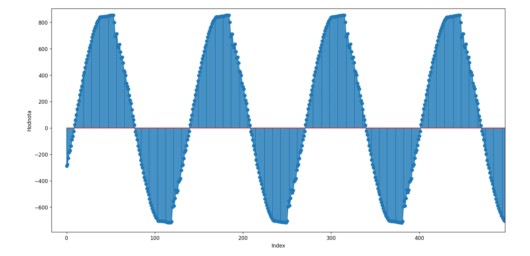

on STM32F303 I use ADC with DMA (12 bit), I measure signals on 3 channels + Vrefin.
The input signal is pure sine wave 50 Hz (I can see it on scope). But when I measure it with ADC, so there is distored sine wave, I tried to change SAMPLING TIME, and also Sampling frequency. It changed, but this is the best result what I have got, but still distored. Is there any chance how to solve that problem?
There is no saturation, there is reserve in amplitude

AScha.3
June 7, 2023
this looks like clipping...
show at input 50% of this amplitude.
waclawek.jan
June 7, 2023
What's your hardware? Is VREF+ rock stable? Is ground arrangement perfect? Is the AC input perfect? Oscilloscope measurement was directly from signal on mcu pin? DC measurements are stable? Try to measure only one channel. Show individual points (read: where is the continuous curve from?)

Oscilloscope measurement is directly on mcu pin, DC measurements look stable.

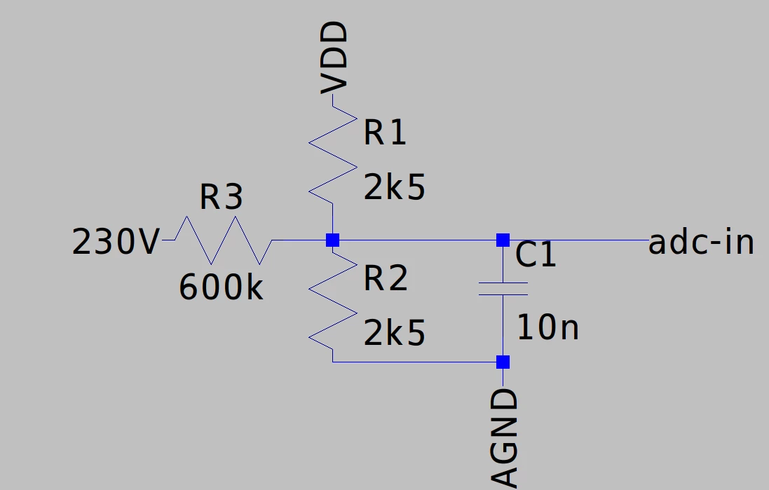

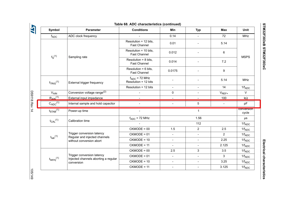

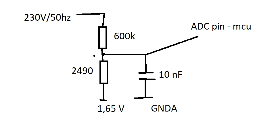

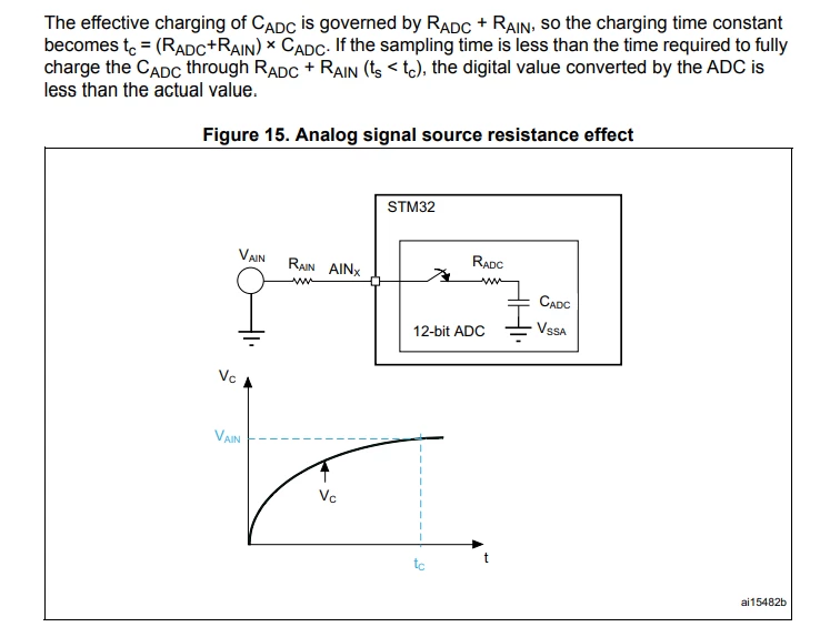

I measure 230/50Hz like that: Maybe the current is to small to charge sampling capacitor in MCU?
_legacyfs_online_stmicro_images_0693W00000dDPH4QAO.pngalso I found this image, but what is the value of Cadc?
waclawek.jan
June 8, 2023
_legacyfs_online_stmicro_images_0693W00000dDPJ5QAO.pngJW

Thanks! OK it looks like my sampling time is too fast . I have it already on 610_5 cycles, so I have no option to slow it down.
How can I sove it?
  • I can reduce the clock speed of the mcu, but I do now want.
  • Maybe I could measure on the same channel several times in a row and after that change the channel?
Some recommendations?
AScha.3
June 8, 2023
?? why ?
? 810 cycles ?
too slow. try 8.5 cycles .
and half signal , 2490 -> 1k5 or so, just test !

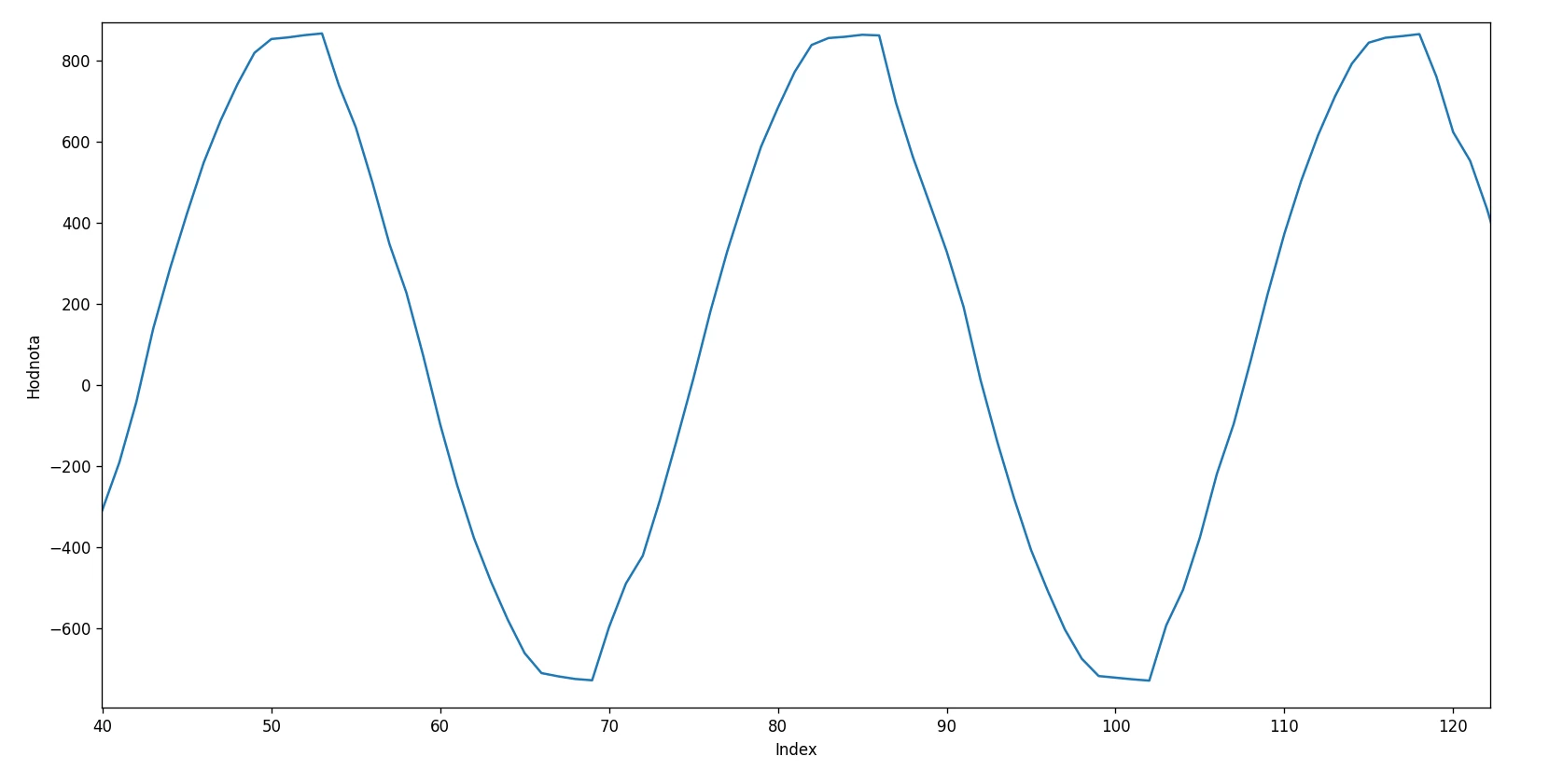

JR2963
JR2963Author
Senior II
June 8, 2023
This is when I use ADC_SAMPLETIME_601CYCLES_5:
and thisi when 7_5 cycles:
I use ASYNC clock mode
AScha.3
June 8, 2023
this looks like: beginning clip / limiting and opamp with high feedback -> oscillations , when recover from overdrive.
again: show at input 50% of this amplitude. or use circuit, like i did for mains aquire:
_legacyfs_online_stmicro_images_0693W00000dDQ88QAG.png and use 7.5 cycle .

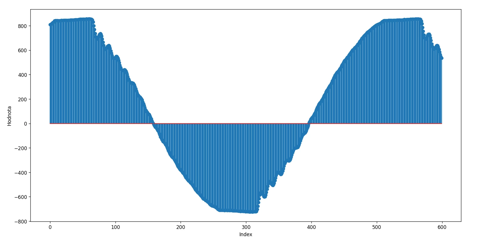

And this is with Sync clock/4 with 180_5 cycles:
Also I tried to measure each channel 2 times in row, and use only the second measurement. But it has basically no effect - result is the same
waclawek.jan
June 8, 2023
Where is the 1.65V coming from, and how does that look like on the oscilloscope?
JR2963
JR2963Author
Senior II
June 8, 2023
I am sorry, now I can see on the scope the signa is not pure wave.I hadn't really seen the distortion before!
Anyway the 1.65 is from OPAMP, but now when the input signal is distored...
I do not understan that, it is 230 Volts throught the isolation transformer directly to the voltage divider...
waclawek.jan
June 8, 2023
Also, don't you try to use the ADC in differential mode? If so, have you read the Errata?
