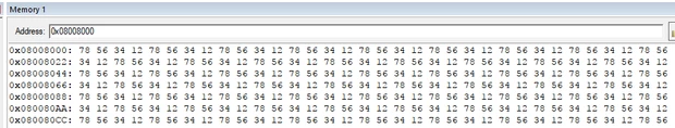

Hello I am looking at the STM32F429 Discovery board Flash memory sample source as below.
I'm recording Hex values in flash memory.
The sample is to be input with a value of 4 bytes Hex ((uint32_t) 0x12345678).
Tell me how to write text (hello world) and date (2017-11-09) to Flash memory
Thank you.
Have a nice day!!

<Memory
Debugging>

    So use a uint32_t* pointer and advance it with each write
    char str[] = 'Hello World!';
    uint32_t *p = (
    uint32_t *)str;
        if (HAL_FLASH_Program(FLASH_TYPEPROGRAM_WORD, Address, *p++) == HAL_OK)
          Address = Address + 4;

    Posted on November 10, 2017 at 05:15
    Is the date format the same?
    It is all just bytes of data in memory, the processor doesn't distinguish if it is a greeting or a time stamp. The routine you have writes 32-bit words, a collection of four 8-bit bytes.
    Create and manipulate strings with strcpy(), strcat(), sprintf(), etc
    char str[] = 'Backup generator failed to start 2017-11-09 09:32';
    uint32_t *p = (uint32_t *)str;
    uint32_t WordCount = (strlen(str) + 3) / 4; // 32-bit words in string
    while (WordCount--)
    else
    /* Error occurred while writing data in Flash memory.
    User can add here some code to deal with this error */
    FLASH_ErrorTypeDef errorcode = HAL_FLASH_GetError();
    Error_Handler();
