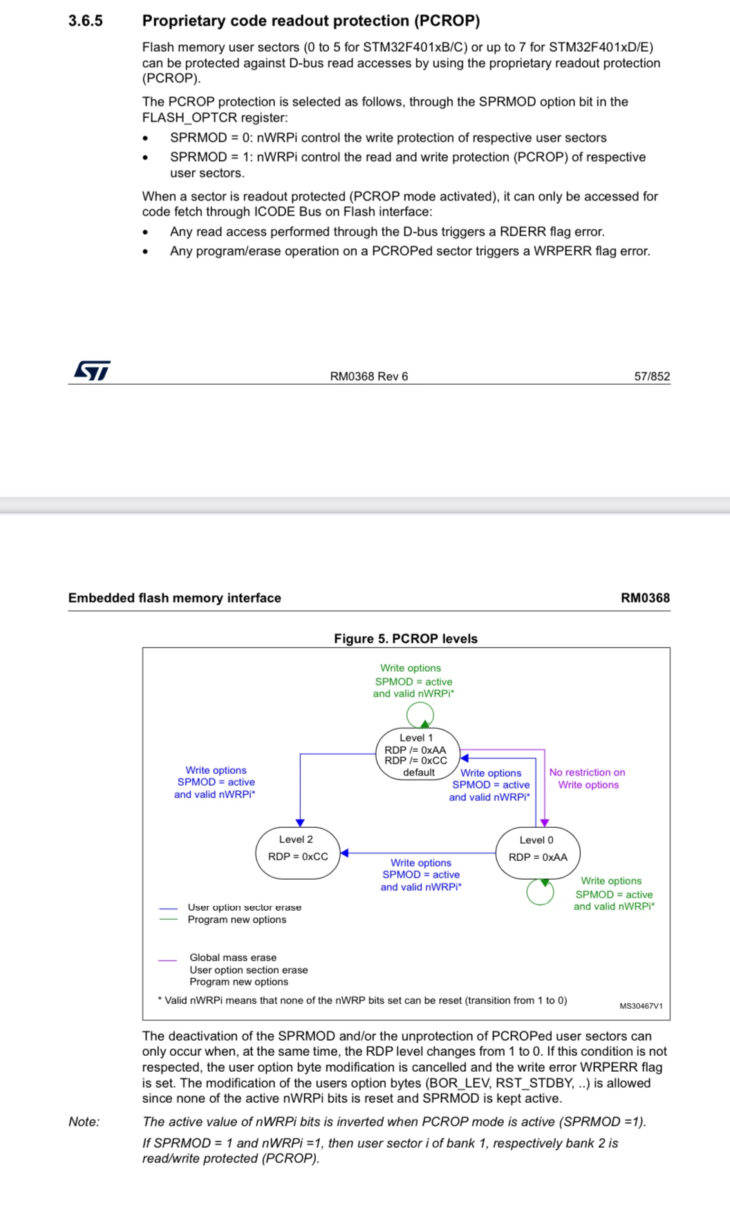

Dear @themarcman ,
This may help , indeed that bit for PCRoP feature is a bit special and to reset it , and RDP change is required on same time  . Can you try using the STM32CubeProgrammer GUI instead and use unitary operations .

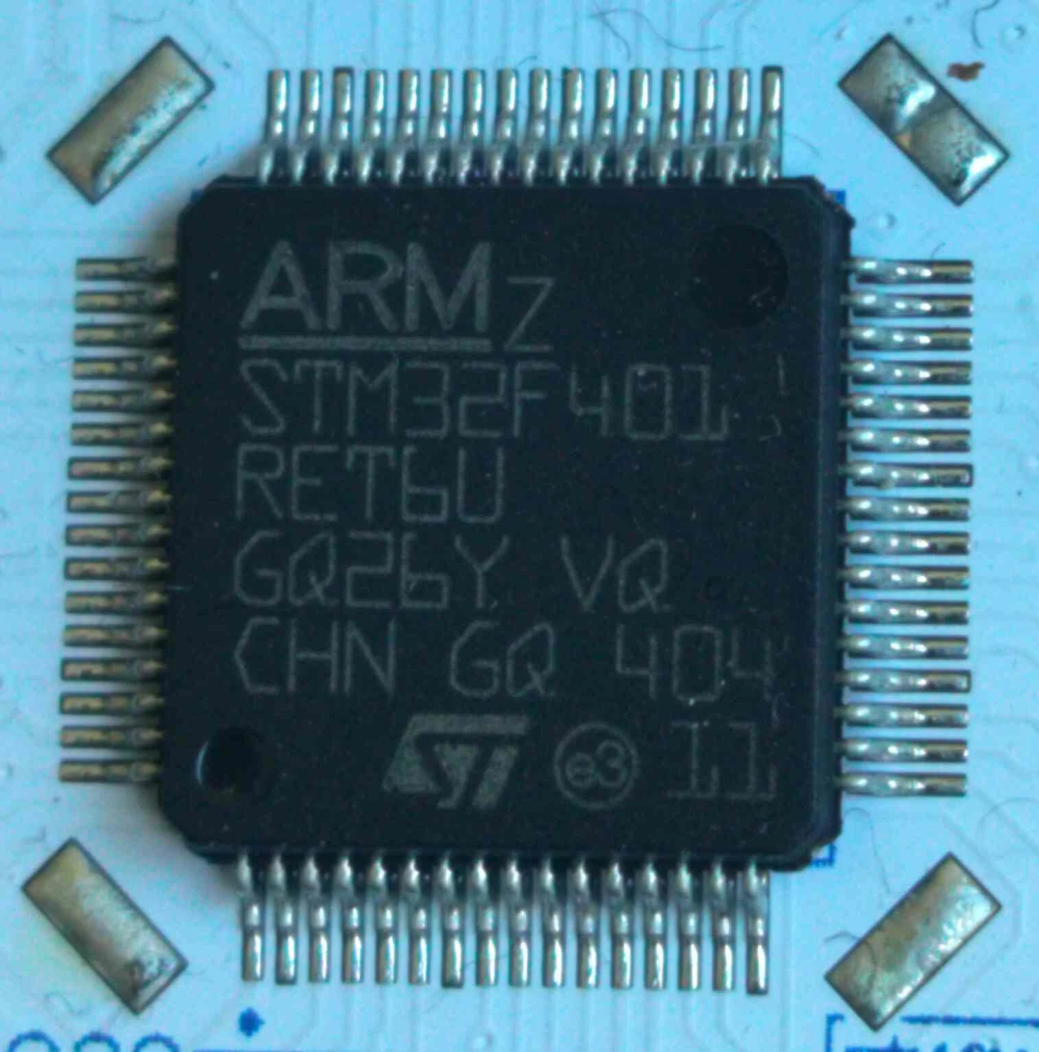

Dear @themarcman ,
Can you please provide the device marking on top of the package and also confirm if other Erase/programming operations on the flash are working fine?  so only sector write protection, or/and any modification of options bytes is also not working?
Let us know
STOne-32.
Apr 5, 2025 12:50 PM UTC
Here is the device marking on top of the package as requested.
packagepackage

Apr 5, 2025 4:55 PM UTC
Thank you so much this solved it.
I remember reading around this area but I stopped right before because it did not seem relevant.
I first changed RDP to level 1.
Then in one go changed RDP to 0, SPRMOD to 0 and all RPx to 0.
My understanding is operations on RPx can only be done during this specific transition of the state machine.
I then switched SPRMOD to 1 again because I could not flash code otherwise and this fixed my problem.
Not sure if I could've simply switched RPx to 0 during that transition without SPRMOD, I'm still don't fully understand this.
