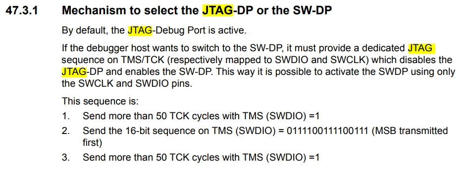

Hello @Tushar_4
if you want to disable the JTAG-DP and enable the SW-DP you have to use the following instructions according to the RM0440:
But if you want to just disable the JTAG you can do that by selecting any mode (input, output or analog) except alternate function mode for all JTAG pins.
Best Regards.

Hello again @Tushar_4
For more information about enabling / disabling the Debug on STM32G4, I suggest you take a look at the Read protection (RDP) part of the RM0440.
PS: Be careful, once in level 2, it is no more possible to modify the Read protection level.
